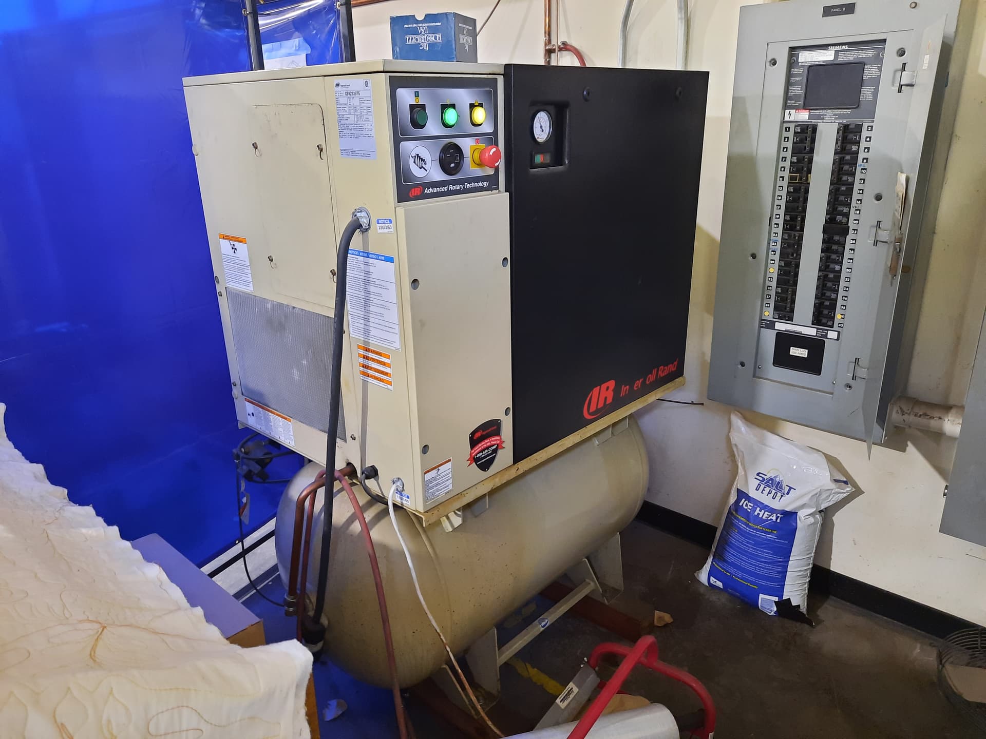

The air compressor is 60 gallon

That’s the volume of the tank. What is the compressor rated at producing compressed air at? Usually says something like “12 CFM @ 100psi”.
Can you send us pictures of the air filtration and drying system you’re using before it gets to the plasma cutter? These things need STUPIDLY dry air to maintain functionality.

On the air compressor thing, @holla2040 had a good point in a different thread. When the compressor comes on, pause your cut until the compressor shuts off.
Our compressor turns on around 110psi and ramps back up to 125. My Cut45 regulator is set to 75psi I think. In our case, our compressor can easily stay ahead of the torch because we have a large one.
I think it’s 10 CFM at 90 PSI is that sufficient?

Yea, should be adequate

@sarahkralik I havent seen anyone mention your air cleaning and drying setup. I had similar torch problems and it turned out my air was dirty and wet. I ended up getting this Amazon.com that cleared up that problem. Make sure to drain the water out of your air tank before the cut and after each refill that it does during the cut.
