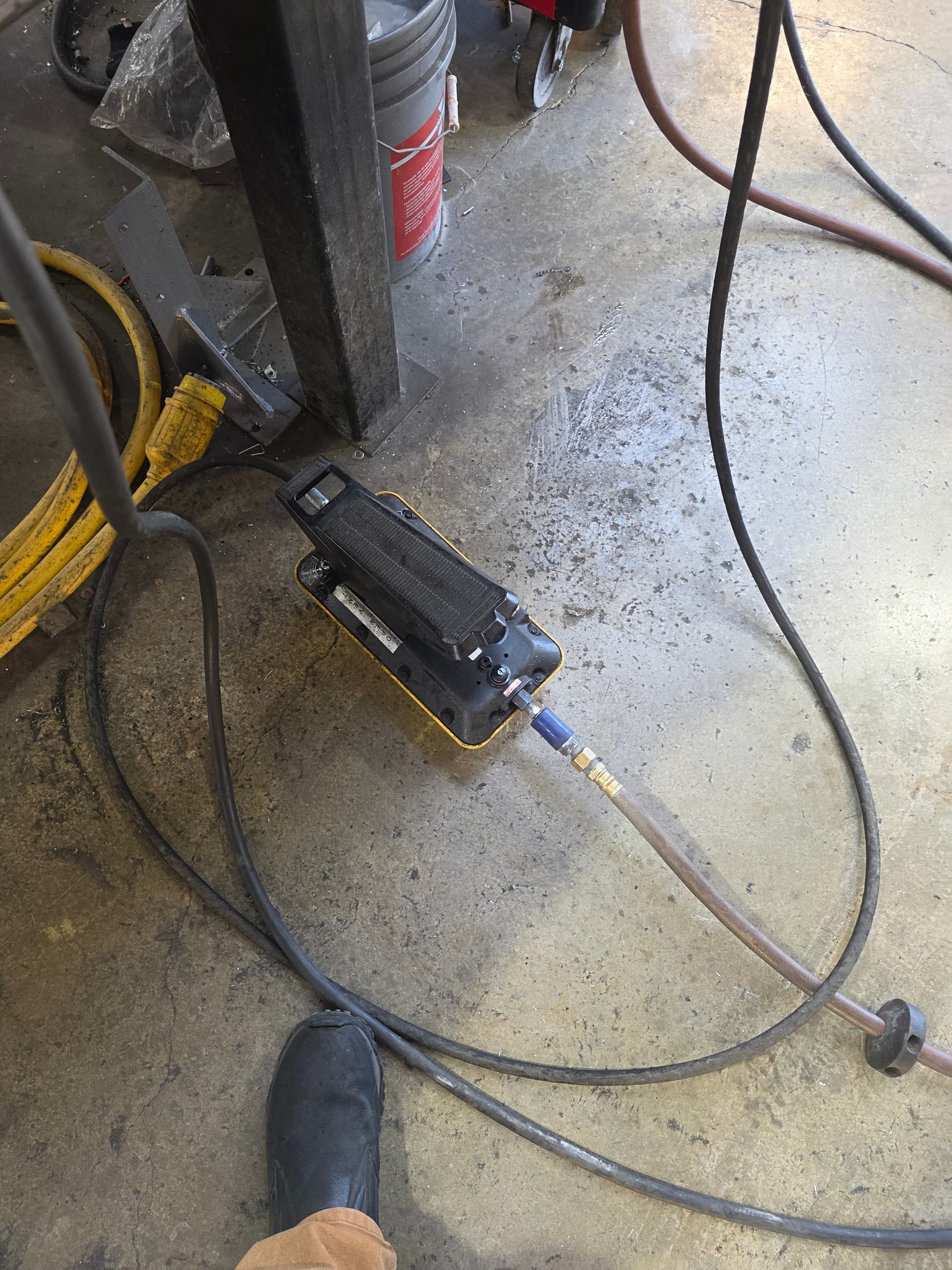

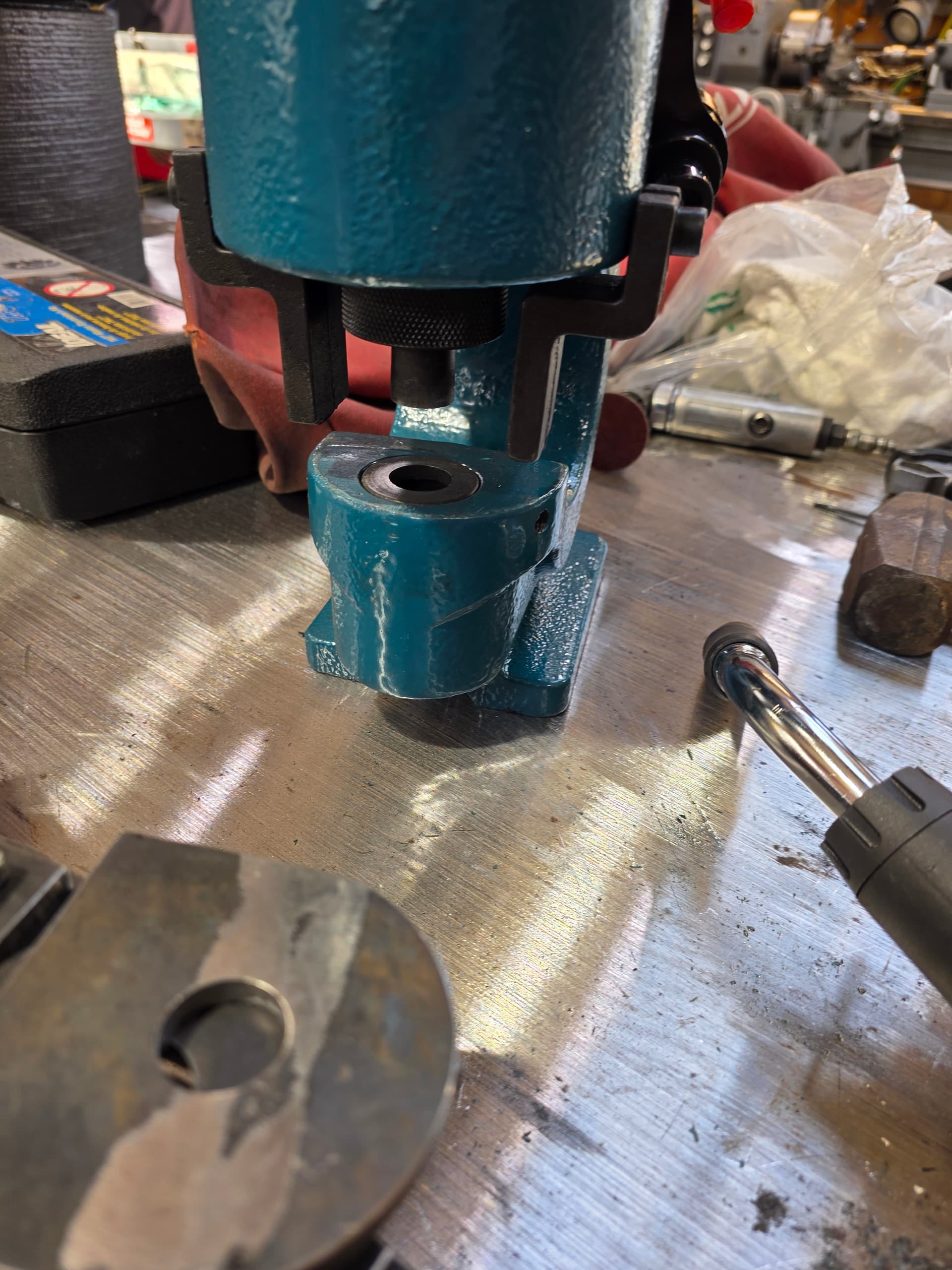

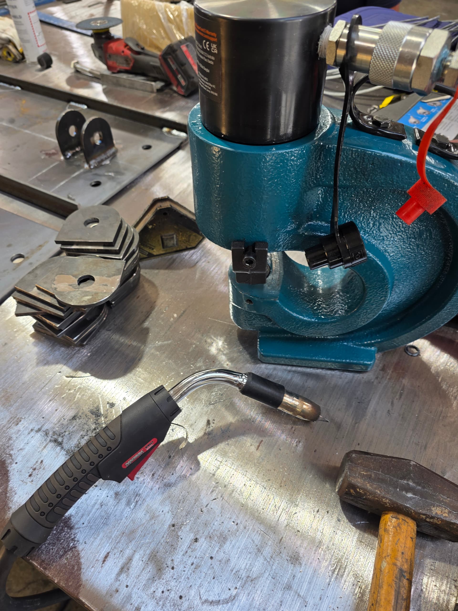

I bought this CH 70 from Vevor a couple of days ago. It is the best tool I have bought in many months. $190 35T metal punch. Now, grant you I already own the $900 Energypak foot 10T pump.
It cuts holes without a flinch. I cut 25-3/4 holes in 5 minutes. It states that it can punch holes in up to 10 mm plates. (I hate the metric system.)

My needs go more like 14mm (1/2” in reality). If you do a lot of sheet metal (yes I called 3/8 sheet metal), and the throat will accommodate your needs, then bingo.
***I mostly play with thicker media.
They make a 80T version
CH-80 is the 50t. Cool $1k+/- delivered.

Jimmy, I am telling you this thing is absolutely the fastest way to make holes in metal. I stepped on the pedal and just smiled. Now, if you don’t have the air-over hydraulic pump, it would be a lot harder.

how do you line it up? only cuts one size hole?
The punches have a dimple in the center. I just brought it down slowly till the dimple lines up. It came with five punches 3/4,5/8,1/2, 3/8 and 1/4.
