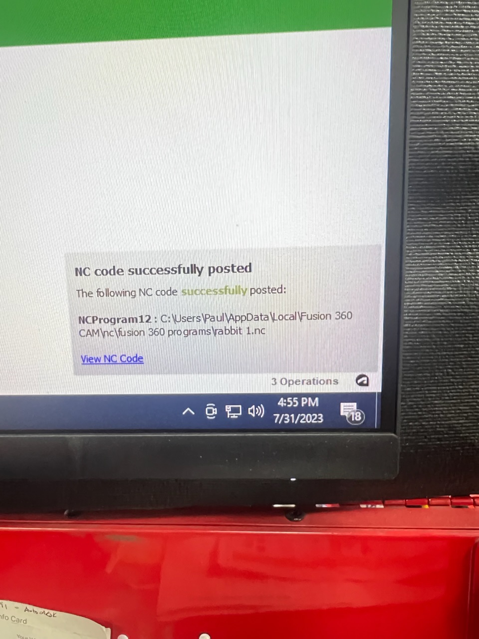

Yes I need to clarify though after I post process and it says that it was successful when I go to firecontrol to upload the file it’s not there. Where could it be going to?

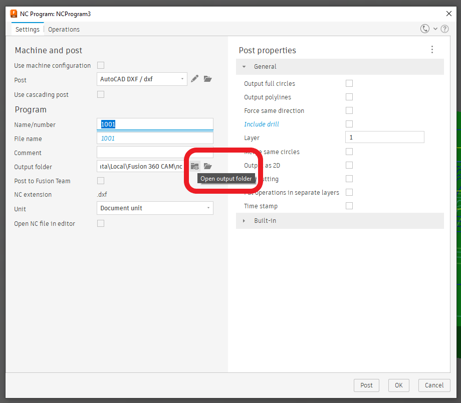

Fusion or SheetCAM? Occasionally when I loose a file, I’ll go back and re-post, noting which directory is selected. If Fusion, also make sure the extension is still .NC

The default location from Fusion is My Documents/Fusion 360/NC Programs.

This what tool path it shows
If I manually type it in in the gcode files it says it is invalid
click this folder with the eyeball and it will open the output folder you have selected.

Ok I did find notepad and it gives me the name but it doesn’t show up in firecontrol
Where is FireControl looking when you select the green load button?
It’s looking in my old files of fusion 360. Can make a new folder and get it to show up there.
Just change the Output folder from the Post screen. Select the folder next to the one with eye (as Tin mentioned above.) Navigate to your old Fusion files folder and click Select folder.
