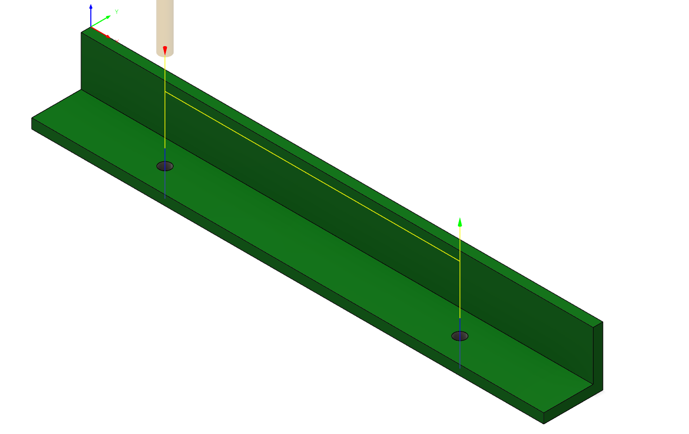

I attached a simple program I made in Fusion for a bracket with two drilled holes, image attached as well. If you can follow along with that code and the image, maybe you could go the manual route. If not, get Fusion or pay someone with Fusion to create the programs for you once you have all the coordinates. Aluminum valve bodies, probably can go off the cutting parameters that Langmuir has created. I do notice the HSS drills cut oversize, so I always start small and work my way up, but again sounds like you are planning repeat work, so may be able to splurge on some nicer carbide drills for the specific sizes or something.

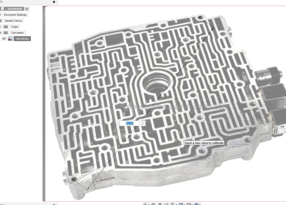

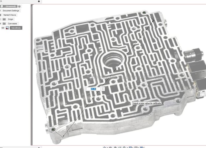

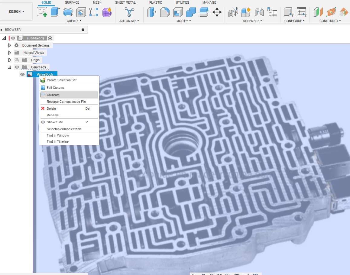

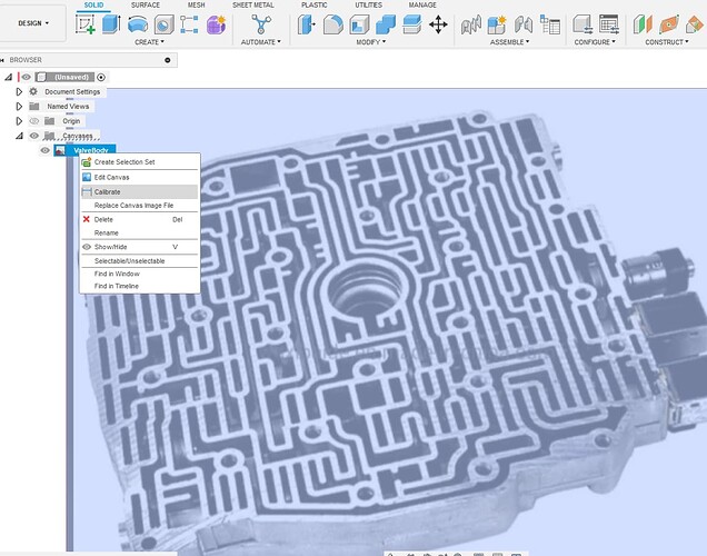

If your part (plate or body) has a flat surface that you could get a really good photo or image (such as from a flat bed scanner) you could import the image as a ā€œCanvasā€ in Fusion 360, then you pick ā€œCalibrateā€ and pick two easy to identify spots that you measure:
Then you input the actual value and then the image is reduced or increased to that size.
You would then have a fairly accurate model to start you design for holes and slots.
(Note: The image I used would not be appropriate because it is taken at an oblique angle.)
