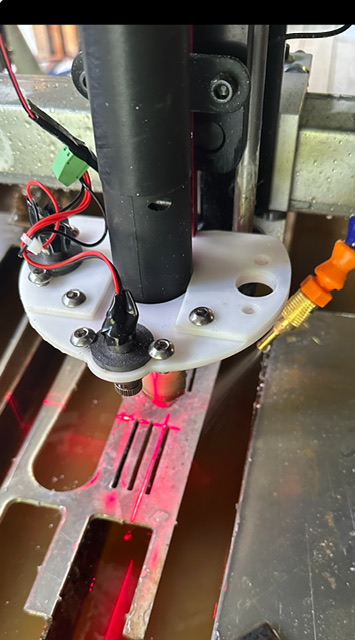

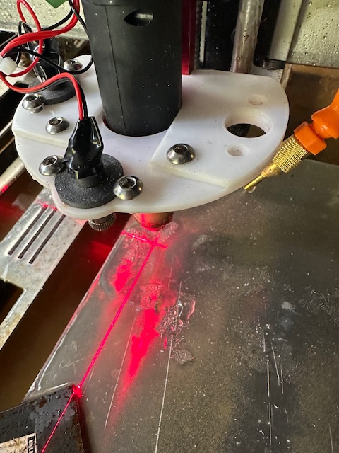

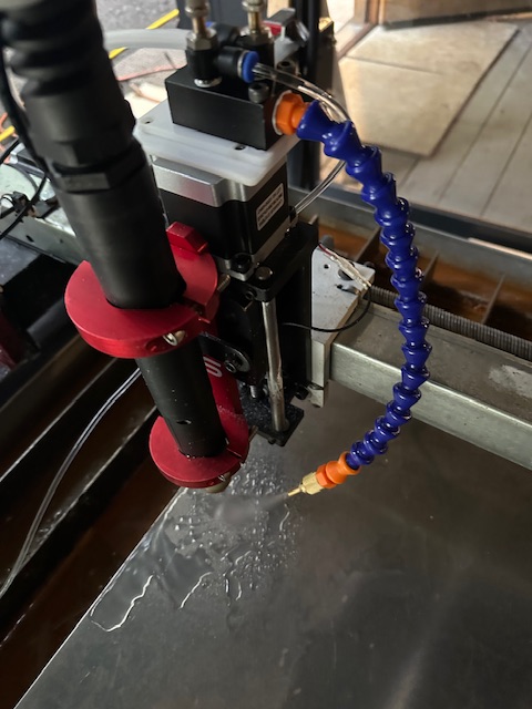

I would ignore the charts, make some test cuts starting at a low speed then bump up 10 each time. Example start a test cut at 30, then 40, 50 60 70 80 90 100 110 120. Run these first batch at 30amps, then run a test at 32.5, 35, 37.5, 40, 42.5, 45. Somewhere on the tests you will find the best version. You can get a water bottle or pump sprayer like for spraying weeds etc, run it while cutting and you will get a benefit for warping.

Success, increased cut speed & sprayed it with water.
