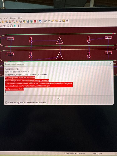

My Post processing error
I’m getting this error when I’m trying to run. The post processor says Pierce height must be below rapid safety clearance, but I have tried raising and low earning the pierce height and nothing is happening. Does anybody have any advice?
Go to “options” and click on “job options”. Set the rapid clearance to a value higher than your pierce height. Mine was set at .3937” by default.

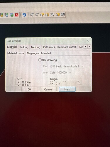

Total noob question but how do I either enlarge or scroll down the job options because I’m not seeing the standard option for either
Use the mouse to clock and drag the bottom of that box down.
