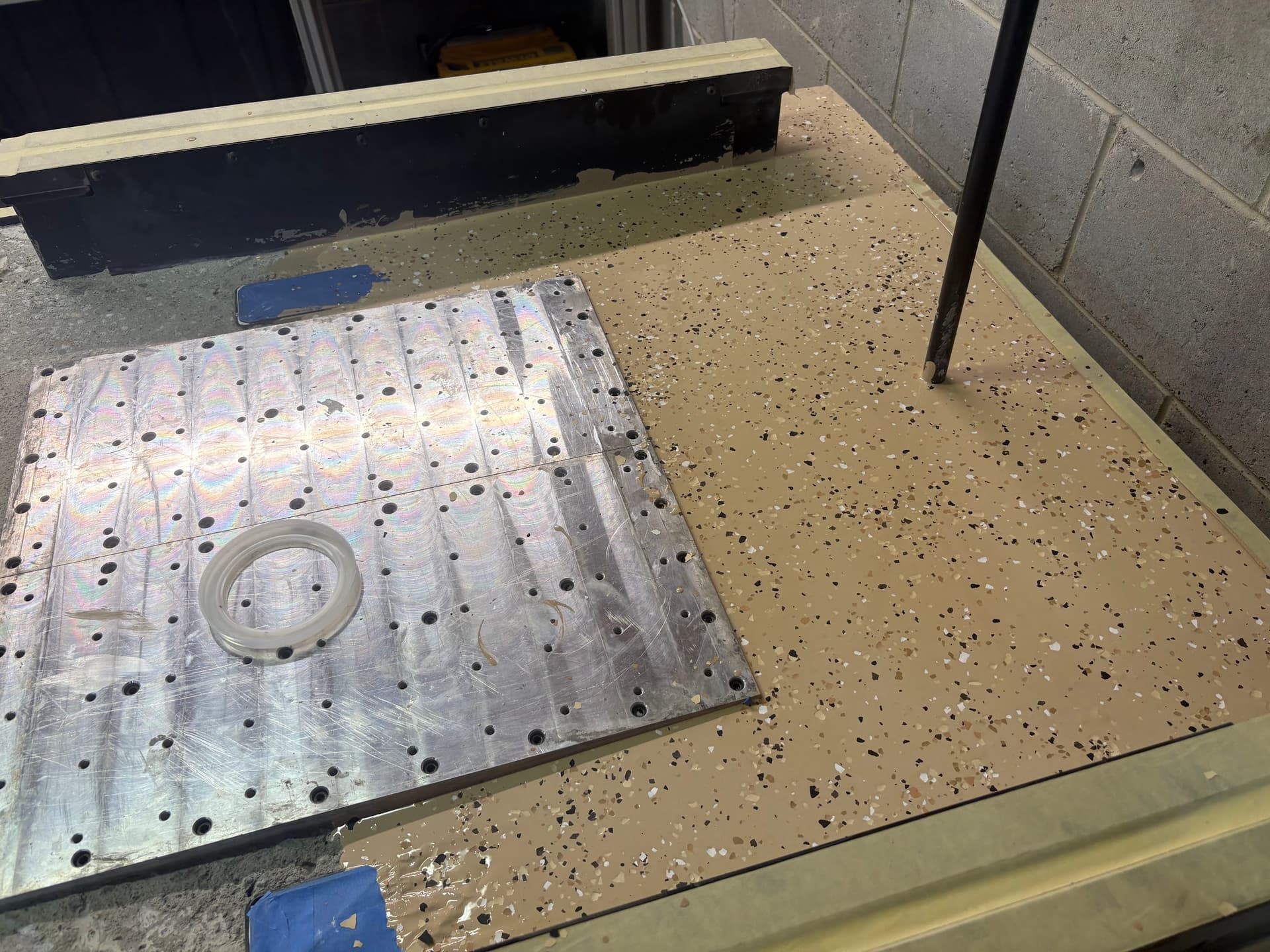

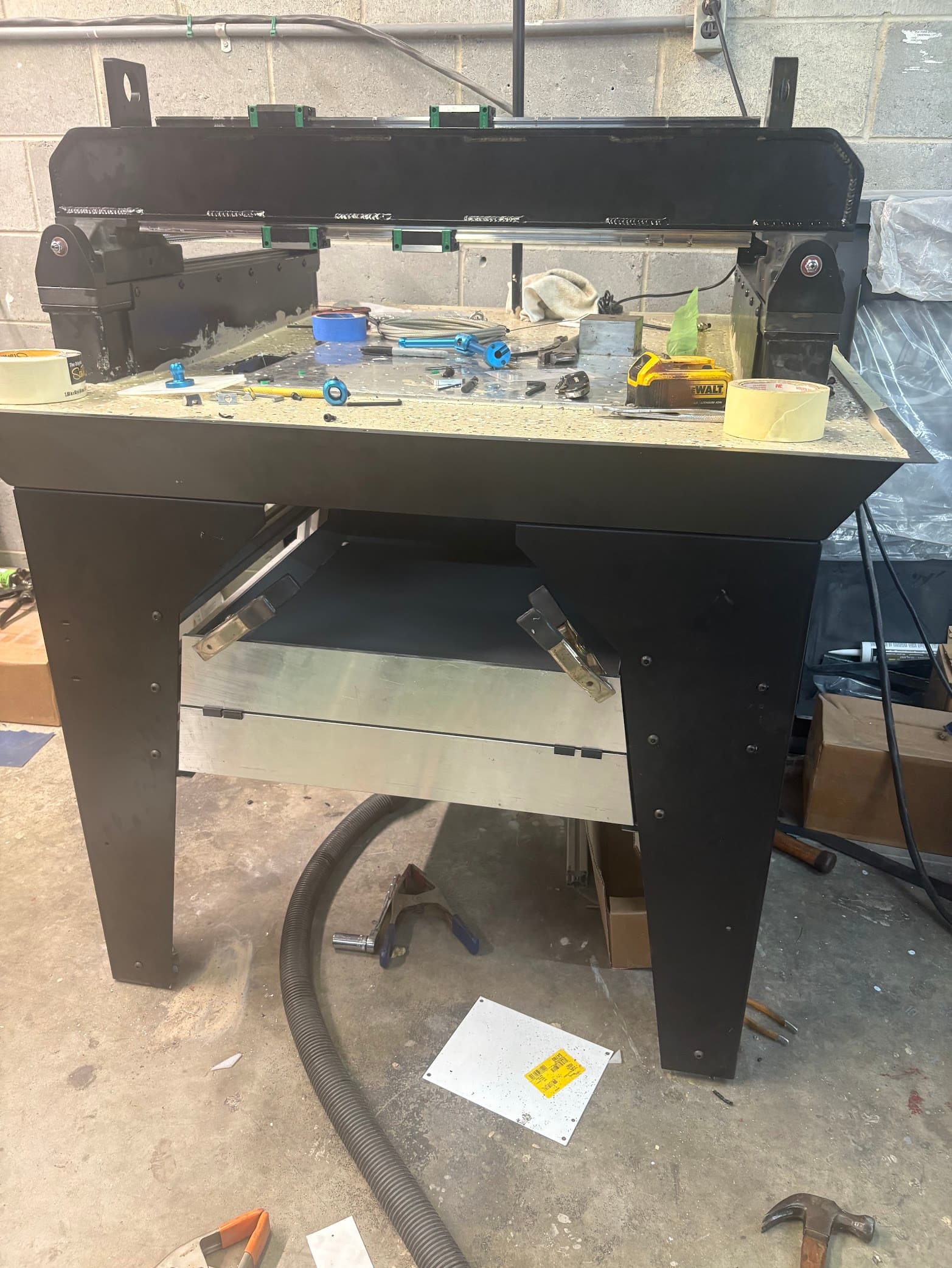

Some pics of my build/mods:
Contoured the concrete and then did a two-part epoxy pour, re-sloping the machine for each half for better coolant flow to drains. I didn’t see what some of y’all were doing with the shower drains until too late…wishing I had done that.

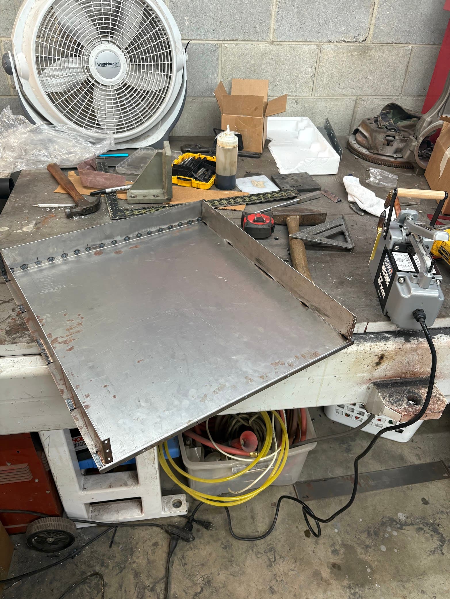

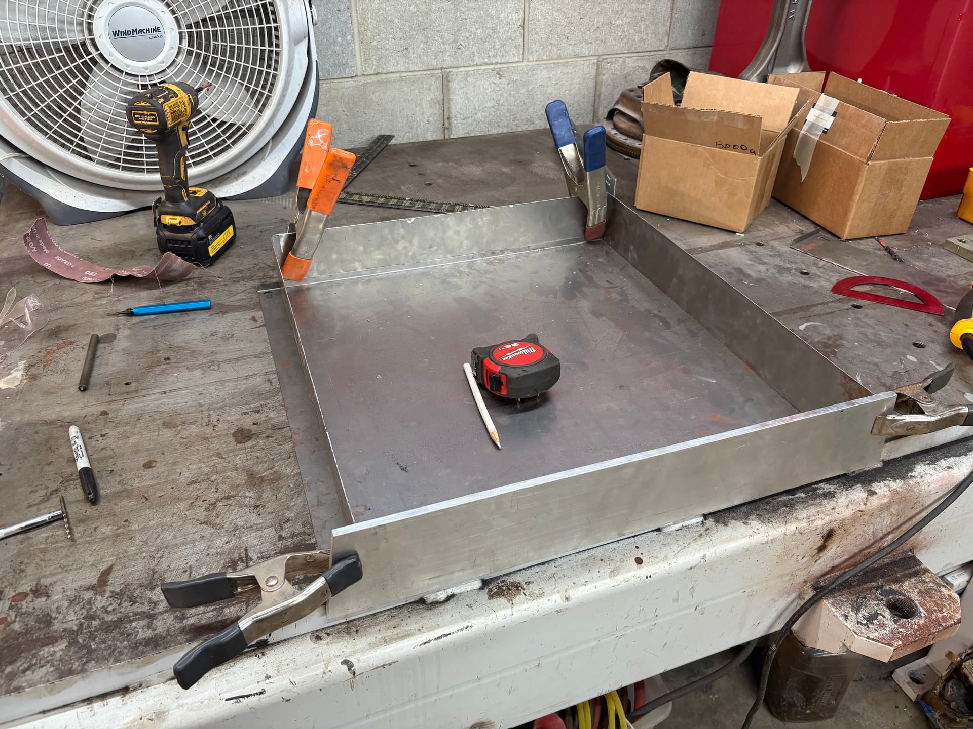

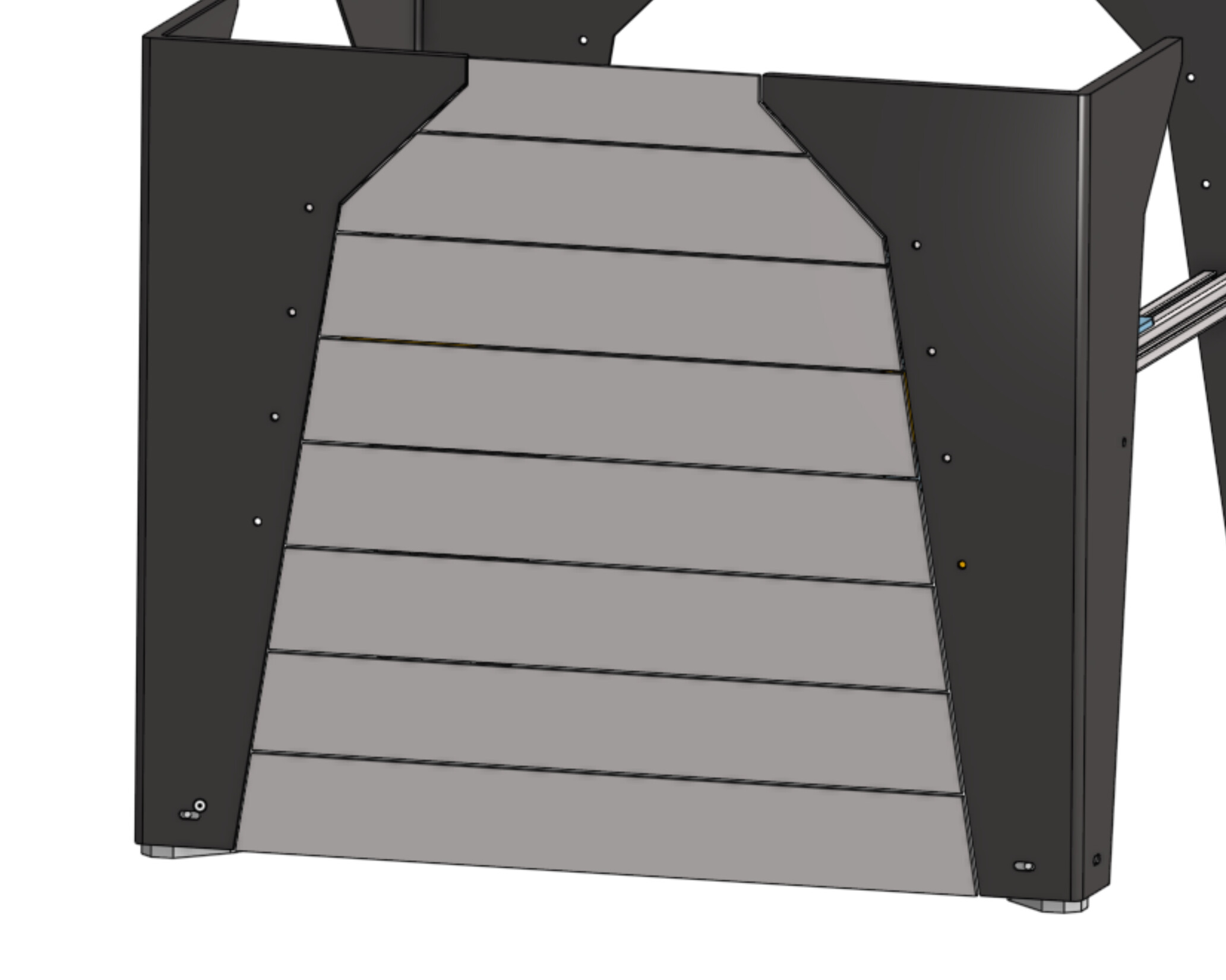

Building some integral drawers using some scrap extrusion and 14ga sheet metal (I’m too cheap to buy a tool box and I have a ton of practically free heavy duty drawer slides)
Should create a nice clean front with a push to open spring latch.
