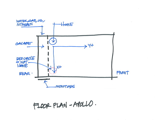

For someone as new to this process as I am, the coordinate system was a bit counterintuitive compared to a traditional X and Y axis layout. As shown in the sketch, the machine’s Home position on the face of the garage, which Langmuir technically designates as the “rear” of the machine, places the X-axis origin at the upper corner of the table rather than the lower corner. This misunderstanding was entirely on my end, as I had not fully grasped the machine’s coordinate orientation.
Once I homed the machine, I positioned the locator (laser head) over my material at the upper rear corner as shown in the sketch. I then set the X and Y coordinates to zero, homed the CHS and AFS, entered the material parameters, and loaded the material. After following that sequence, I was able to successfully run the program four consecutive times without issue.
