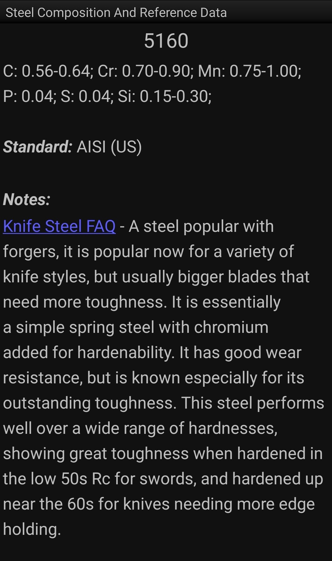

I mentioned 5160 in one of my first posts as a superior alternative to 1095 for his use case. I think if he’s looking for something tougher for a throwing knife, it may be an even better choice than 4140PH because it can get a little harder while also being tough as an old boot. 4140 at 50Rc is tough, but I wouldn’t expect much for edge retention (or in this case, tip sharpness) with only 0.4% carbon. Not saying it’s a bad choice, just that 5160 may be a tiny hair better since either is probably more than tough enough.
Yeah I wouldn’t normally use 4140PH for a knife but if you’re just looking for something to be throw and beat up than maybe it would be a good option. I agree 5160 is a great choice. I just wouldn’t go to the trouble of using high quality steel if you’re not going to heat threat and temper it. That kinda defeats the entire purpose of why these steels were developed in the first place. There are a lot of steels that are better then your basic high carbon steel but I don’t normally recommend those to guys who are new to knife making. I try to start them off with something that’s easy to find, easy to heat treat, not crazy expensive, and pretty forgiving and idiot proof. :slight_smile:
