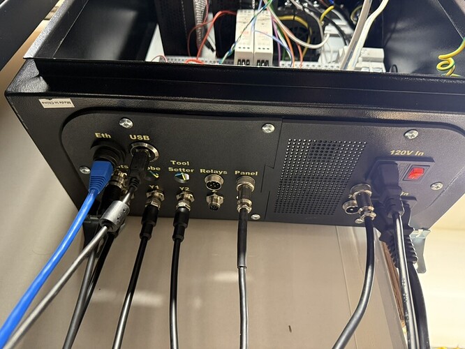

I used this box, which Amazon doesn’t list anymore but you can at least see the concept:
https://www.amazon.com/dp/B0CHJYPGDF?ref\_=ppx_hzsearch_conn_dt_b_fed_asin_title_8

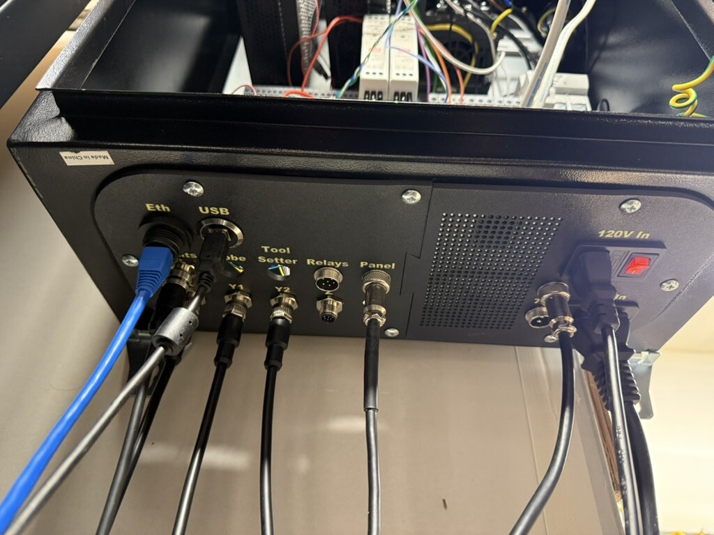

The awesome thing about this box is that there is a removable panel at the bottom for ports. I 3D printed a replacement with clear labels for everything as well as an air intake:
Another nice feature is that there is a removable interior panel, so you can do initial layout and wiring on your workbench without reaching into the box.
I did drill one hole at the top of the enclosure for an exhaust fan and a second small hole on the side for the power switch. I otherwise didn’t need to modify it.

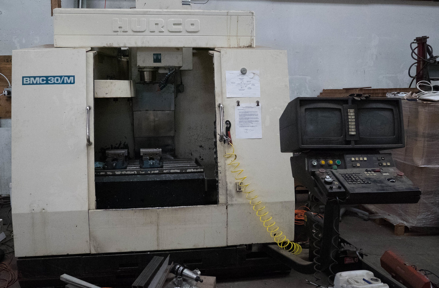

I did do such a retrofit once. There is a lot more to figure out on a VMC, but it is a budget way to get a very capable machine. I’ve spent as much on my MR-1 as my friend’s shop spent on a Hurco BMC30/M. We retrofit that machine to LinuxCNC including the ATC (which was a lot of work) and got 10+ years of prototype and production work out of it. We didn’t replace most of electronics and just interfaced to the existing drives since large servos and spindles are expensive.
This machine is roughly the height and width of a minivan, though a little shorter in length. This is what it looked like on purchase day:

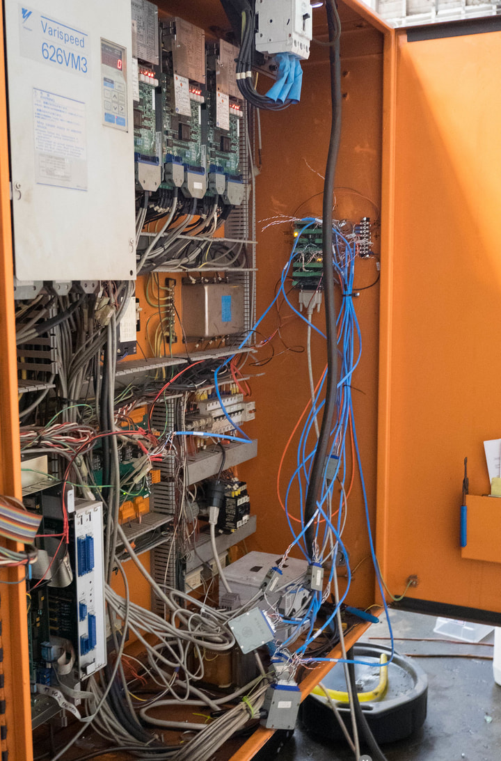

Here is some of the wiring when we were part of the way through figuring out the retrofit. That is a LinuxCNC-compatible MESA board mounted to the wall.
I would say it was easily 5x (probably more like 10x) as much work as doing the MR-1 conversion to LinuxCNC, but I used the same skills in both projects.
