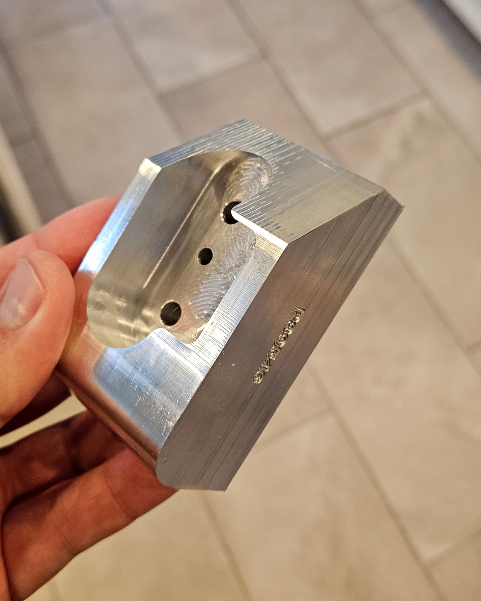

Not a dumb question. I dont but also theres times where you can have more material on the bottom do your whole op full depth cut and then flip it and face off the extra material.
I also want to ask when you indicate off your hole do you indicate off the same side of the part when you flip it? So hole in in the middle | 0 | you touch off on left side do your mill op and then flip it. Do you touch off on left side again or right side?
I indicate the center of the hole using a center finder on both op1 and op2
Gotcha ok that rules out concentricity of the hole. I am gonna hold true that the material is not square enough for a flip without either squaring the material or doing a side indication and not using the hole. Indicate off the side that touches the stationary side of the vise then flip and indicate off the side that touches the moving part of the vise (ie the same side of the material).

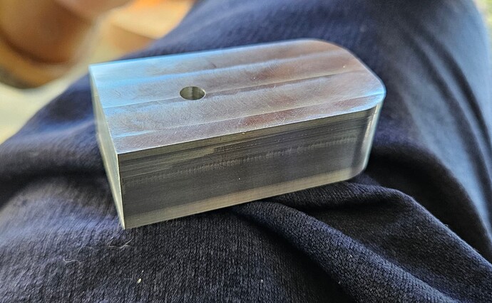

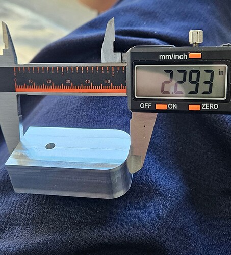

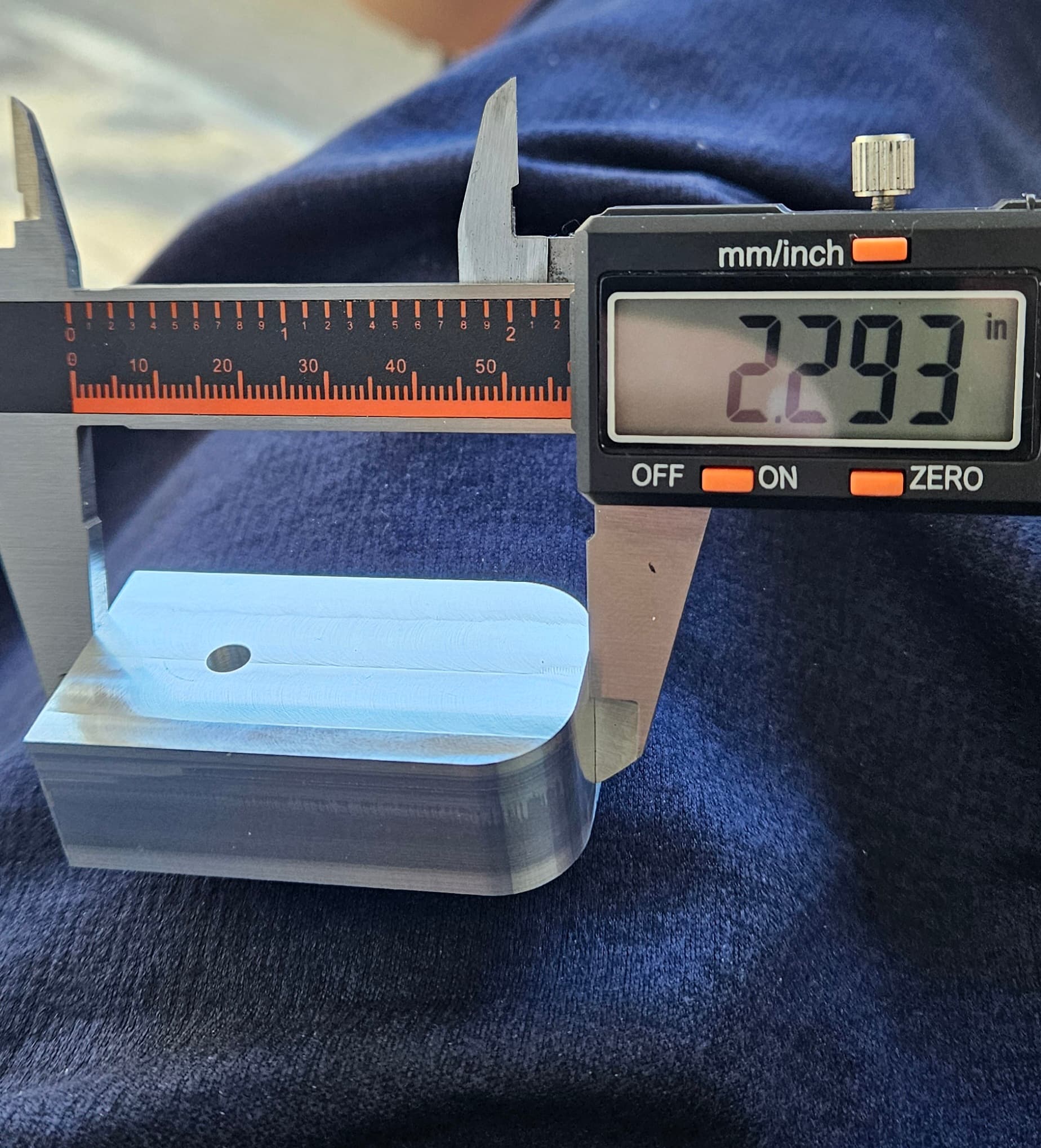

So i have solved the two side flip problem! I squared up all the edges first. That did it. HOWEVER, now I have an even bigger problem i need to solve…. This part is supposed to be 2.25” long, and it’s way off.
But both OP1 and OP2 cut identical, so its something in my CAM? In Fusion360 it says the part size is 2.25…..and even the setup sheet says that. What would be causing the MR1 to be cutting so off distance wise???
Glad that you got that figured out. Over is better than under, i would say side load on the mill. Someone who is better at feeds and speeds will need to chime in. You can also just adjust the offset manually. I am interested though. How far off is the hole to the left side edge (non rounded) is the hole the correct distance? Basically trying to see if one side is long than it should be or both are. What about side to side measuement?
.043” too big is a huge offset. I would expect you to easily be within 0.004” and then to have to chase down to 0.001”-0.002”. I expect there is something hiding in your CAM operations, like the option to “Leave stock”. Check your simulation, does it go right up against the edge of the CAD model?
I think i found the issue. Even though I’ve set my travel compensation many times in cut control it was way off again. I had to recalibrate and it took a full windows restart for it to “stick”. I set it probably 4 times before it finally took
