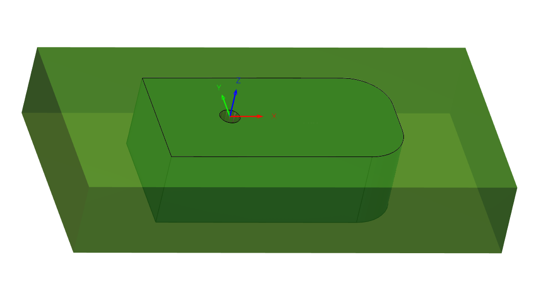

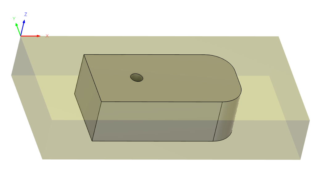

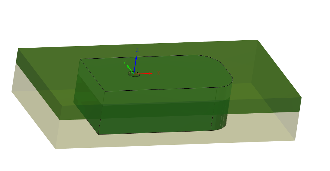

I am practicing with a simple part, but doing (2) ops, requiring a part flip. I am trying to mill the contour approx 70% depth on op1 leaving a “hat” and then removing the hat and taking remaining 30% contour on OP2. The drilled hole is my WCS for both ops.
This is to simulate a tall (Z) part where I can’t do it all in one pass with shorter end mills.

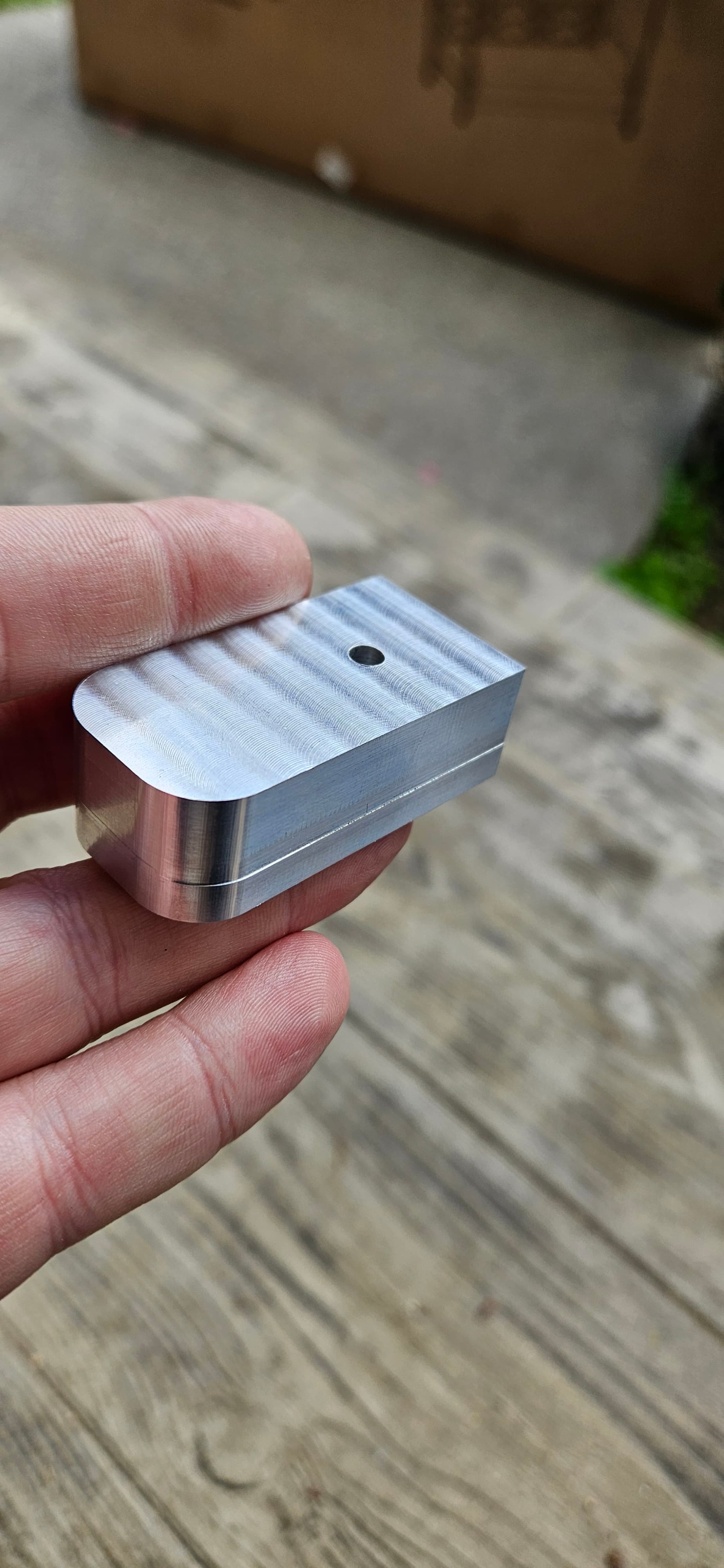

I keep getting this gauging on the finished face of OP1 as you can see in the picture.
Is this unrealistic ? Can the MR1 hold this tight of tolerance to have a seamless profile match after flipping part? Its a very small ridge..but still, its there.
Everything has been trammed to .0005” on the machine. I am a bit of a perfectionist in that regard so been shimming and measuring for a week! Thanks

Thanks for the reply. But i am indicating on the thru hole in both op1 and op2 ; not the outside edges
This is probably the most difficult thing to do on the MR1. I’ve failed to do it perfectly a number of times and have largely just used longer/larger tooling that makes it a non-issue.
The spindle is repeatable enough. Using the Langmuir probe, I haven’t done bore probing GR&R but wall probing is repeatable for me to within about 0.001”.
Fixturing is your most likely culprit. I get much better repeatability on a y facing wall vs an x facing wall. The y facing wall is hard datumed against the vise. The x facing wall can be tilted (even if the parallels are clamped, that only tells you one edge is clamped against them). If everything is not perfectly square to the first side, you’ll notice in the output cut.
Even though you are probing on the bore, if the 2nd side fixturing isn’t square, the walls you are actually machining will still have tilt and show this issue.
Some have opted for the Heimer 3D Probe since you can use it not only for probing but also for checking squareness and fixturing. Because it’s a calibrated mechanical probe, you know there’s no funny business going on.
If I were to try harder down this road, I’d probably get the Heimer and start studying the repeatability of my fixturing/part flips.
The hole is being cut in the first op, so you know it’s square to the sides?
Is this hole drilled before machining? The drill could easily wander that far from one side to the other. Drills don’t make perfectly straight holes.
