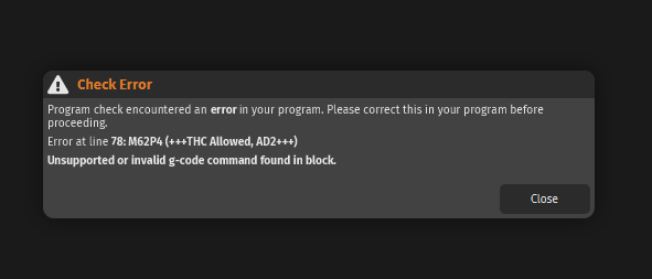

That helps a lot. On those bottom lines where it says ā€œuse code snippetā€, click on those fields and select ā€œnoneā€. Those tools are from someone that uses another brand of table.
You might want to click on that ā€œpath rulesā€ field and see what the default rules are.
I did try selecting ā€œnoneā€ once already but the same thing happened. I think that might have been before I set the pierce and cut heights to 0. This raises another question in my mind, with those set to 0 how does the IHS work?
IHS doesn’t work if you set them to zero. Why did you think you had to set them to zero?
The THC is a Firecontrol thing. There should be no reason to do anything in Sheetcam to enable or disable it.
You have to set the code snippet thing to none on both the tool and the jet cutting operation pages.

you have probably seen this a million times but here is the error message I keep getting, the only difference being the line # is always different.

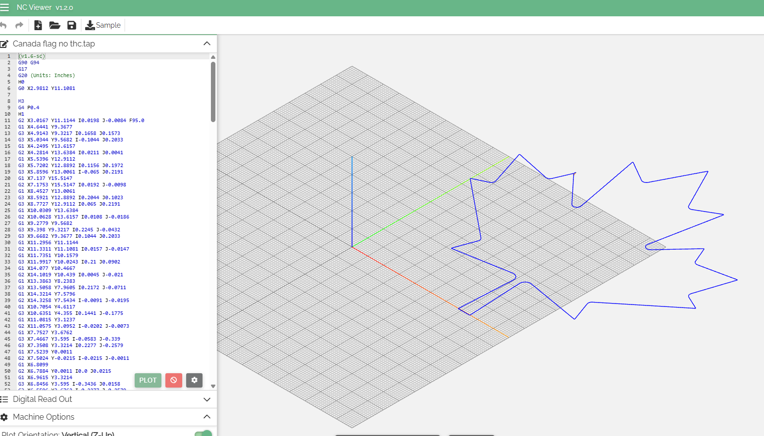

Here is how that file looks with ā€œNC Viewerā€
But there is something deeply flawed with this gcode file, as far a typical files generated for FireControl. There is no active Z commands: Perhaps because you turned off not only the THC but also the IHS commands.
I am not totally clear why the image is not completely on the grid pattern. Perhaps that is a clue.
Sticks is correct: Stop trying to use this file.
The file isn’t the problem. There are no Z commands, because he set the pierce and cut heights to zero on someone’s recommendation.
The problem causing his error is 100% the code snippets in his tool set.

I can’t explain your erratic movement, but it could be a computer issue. That is not related in any way to you error message when loading a file. That error is solely from unrecognized commands in the file.
