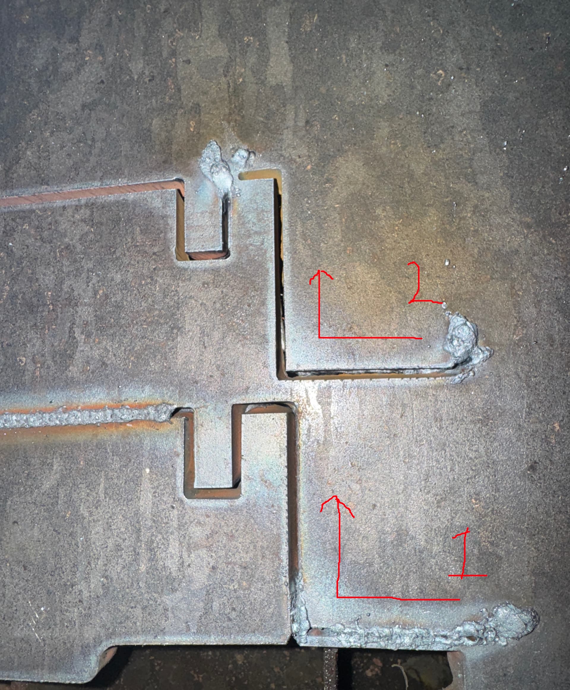

Hi all. I wanted to cut some thick steel so I managed to procure a budget set up.
  1. Titanium Plasma 65A
  2. Fortress 225psi, 5 gallon, oil free, 5.1 scfm @ 90 psi
  3. Langmuir Pro
  4. Las Vegas dry desert
I followed forum inputs to adjust the settings and successfully cut small test pieces that looked real clean.
  • 46a
  • 15ipm
  • cut height: .04 (to achieve .06) as noted by others
  • 1.6 pierce delay
  • .13 pierce height

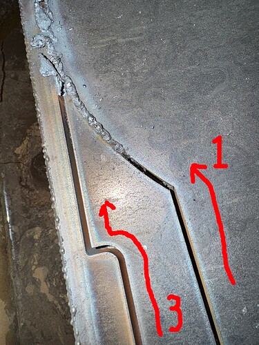

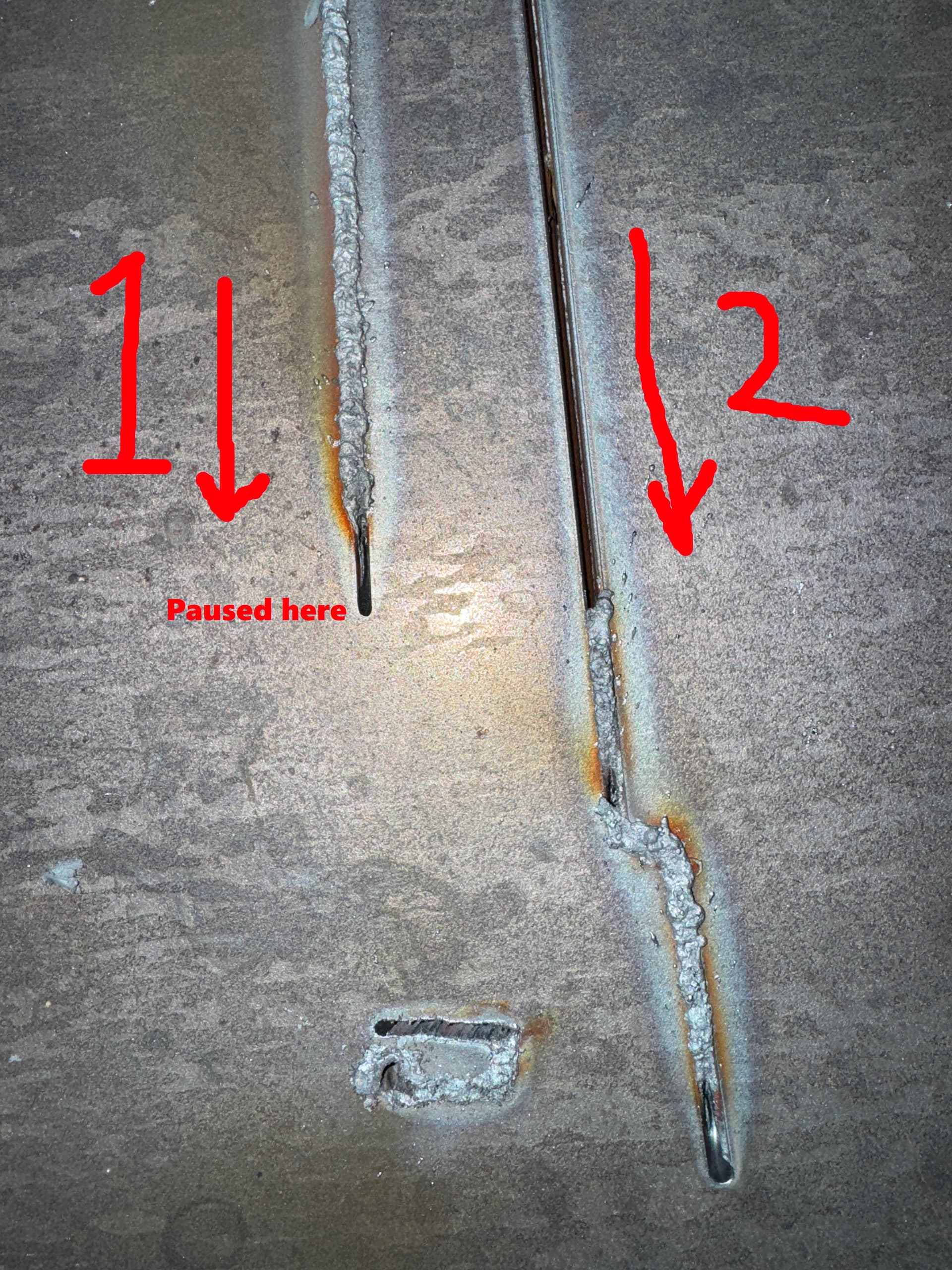

Triple checked everything and went for the dive to cut the actual piece which is 2 ft long. Consisting of three traces, Cutter started the first trace solid the first 18 or so inches then the surface started bubbling up and penetration failed. I could have stopped the program but I let it run its course. The trace looped around and another 18 inches later, I decided to pause the system as the bubbling was causing a lot of spark. Right before I paused, I noticed the arc somehow stabilized and started cutting clean. Regardless, I replaced to fresh tips before trace 2.
After the first trace, I let the machine run the second trace which starts from the opposite side of trace 1. Surprisingly, it cut perfectly well until the last few inches.
The third trace, which starts at the same side as trace 1 and runs about as long surprisingly cut extremely clean despite that I thought it was gonna fail the same way the trace 1 failed.
First take away is that the plate surface to nozzle distance was not consistent. The plate sat slightly higher where the first trace started failing. This leads me to think that THC is not just an “ADD ON“ but an absolutely necessary feature in plasma cutting.
But what did not make sense is how trace 3 successfully finished right next to trace 1.
I’m gonna have to get THC before I resume cutting but I wanted to check with you for any inputs so my next cut can come out successful.
Thank you,
Are you running out of air pressure? Also resembles a bad work clamp connection. On the 3/8 plate or slates? A 5 gallon tank is a bad choice.
Not enough air supply, you need a lot more tank capacity.
You are running out of air, and you are likely dealing with a moisture issue, due to your low CFM and storage, your air has no time to cool and drop the moisture out, before it hits the cutter. Need to have double the cfm and a bigger tank(60 gallon would be good)for machine cutting. You could get away with small jobs with that setup but cutting 3/8 material you are moving slow burning through allot of air on those long cuts. Your compressor likely never stopped running the entire cut? It’s not likely that a 3/8” plate is all that affected by not having a THC setup. Unless the plate came with a significant warp. THC will be nice but what you really need is a new air compressor and at least a descant filter.
I’ve heard it more than enough times that those air compressors are not enough for CNC plasma cutting.
ahhh yes… The damn compressor :man_facepalming:

Tank capacity is one thing, but your CFM’s are barely enough for what your plasma cutter requires.
There will be some loss over your run, especially if you have any filtering in place (which you should).
Get something both with more capacity, and more CFM.
This will defiantly effect your overall load but the only desert on earth you could get away with no water vapour extraction is Antarctic on a cold day.

2 days later, I decided to cut another one. Same setting. Arc struggles to stabilize in the beginning, possibly due to being too close to the edge. Arc stabilizes at turn. Then after the turns, it starts bubbling again.
Tip change. Repositioned ground clamp
Second run, starts out fine then has a hiccup at the turn, recovers, does fine for 20” then bubbles again.
I’m starting to think that maybe the cutter isn’t cut for this job. I’m just getting into this so if anybody sees anything else, let me know!
