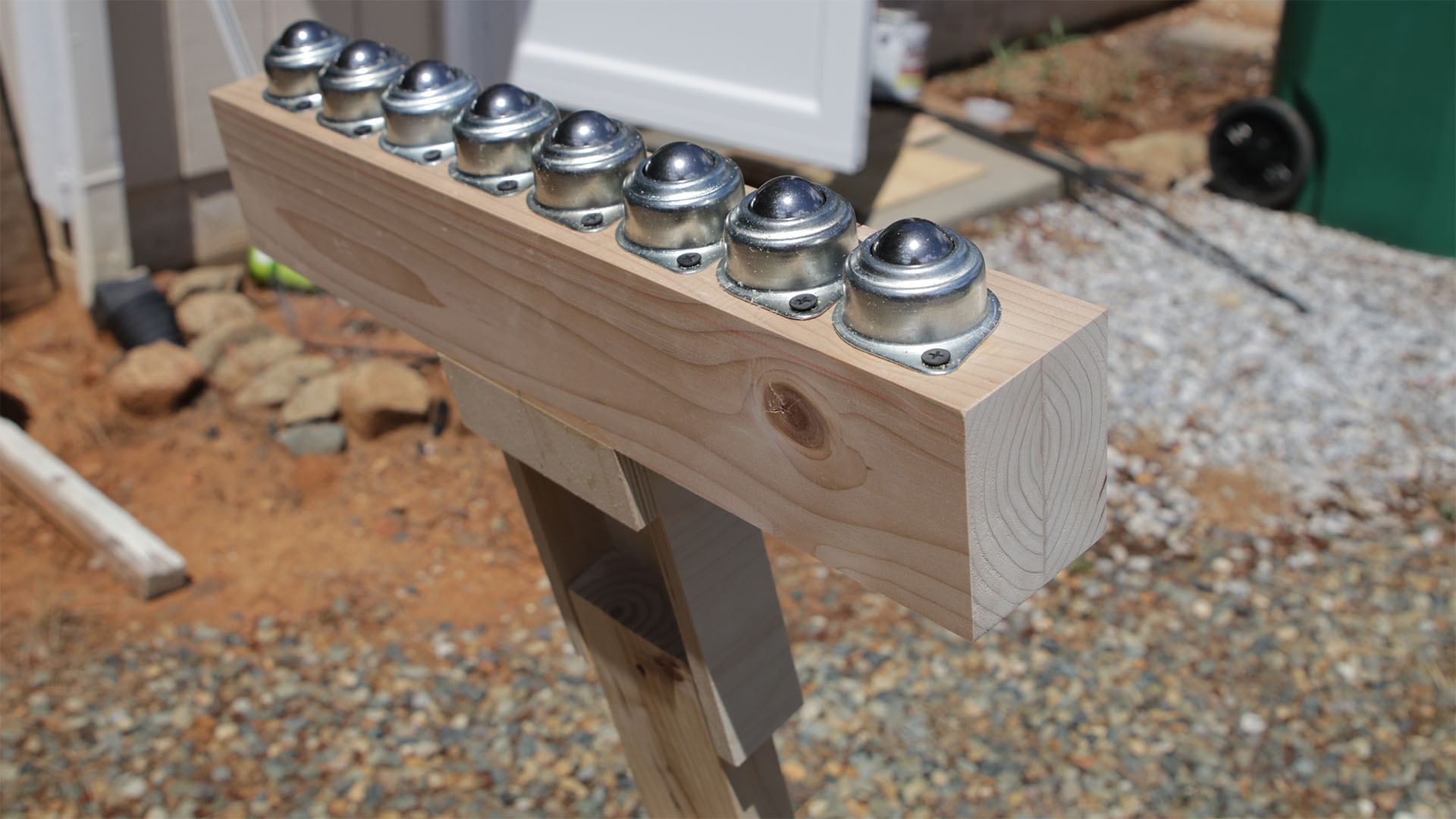

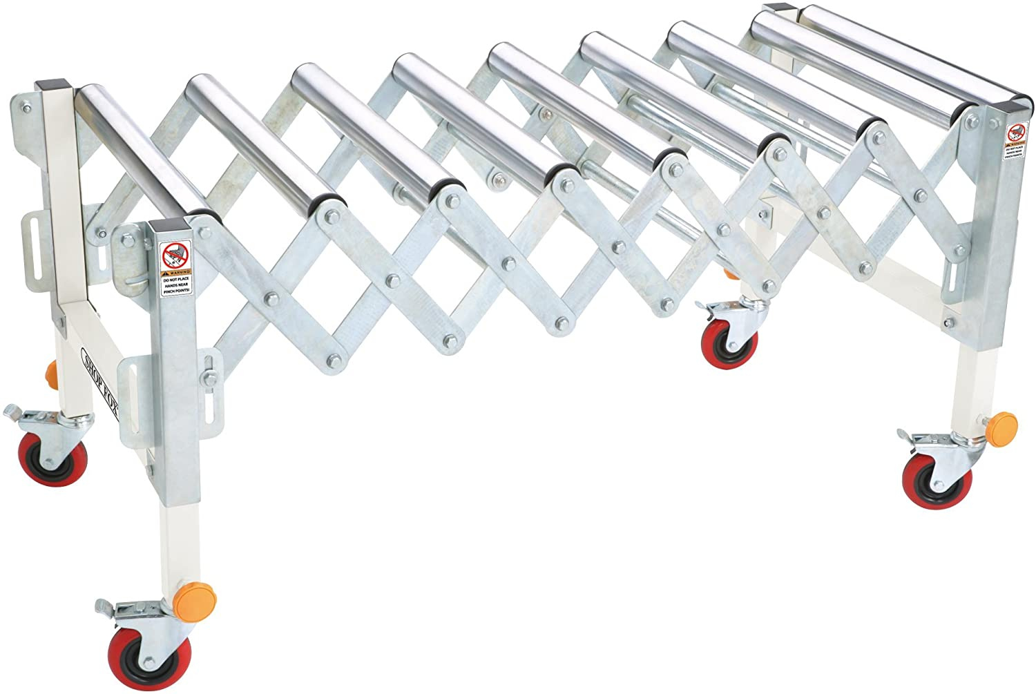

I’m looking for a solution to running full 4x8 sheets through the table. My original plan was to buy or build some collapsible roller conveyors to use as an infeed but not finding a decent product for the money as of yet. No personal experience with the ones I’ve looked at but online reviews of such conveyors don’t leave you with a warm feeling about their arrival. I have limited space and need to be able to store when not in use if possible. Wanted to see what others are doing with this in mind before I waste a bunch of time fabricobbling something together.
I have a lot of sumner pipe jacks and it works but I’m looking for a more efficient system. Thanks in advance for any insight.

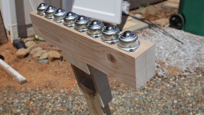

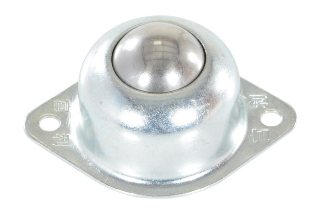

screw these to a basic saw horse multi directional roller balls
