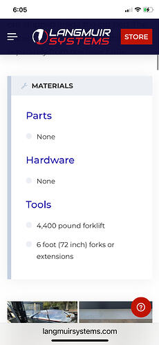

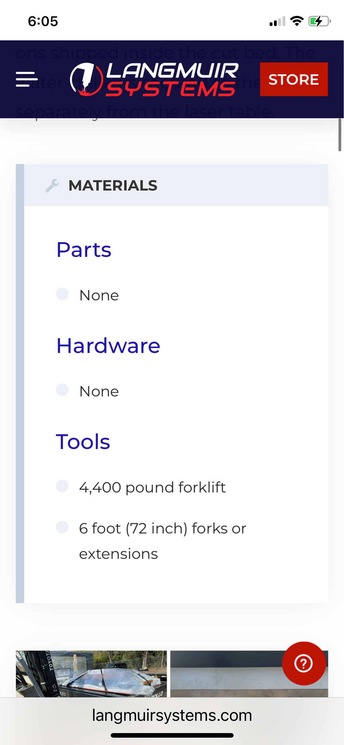

Do you know what the gross weight was? wondering if my fork lift will pick it up.

He Knick I found this in the assembly guide under unloading.

we were told to have at least a 8k with extended forks.
