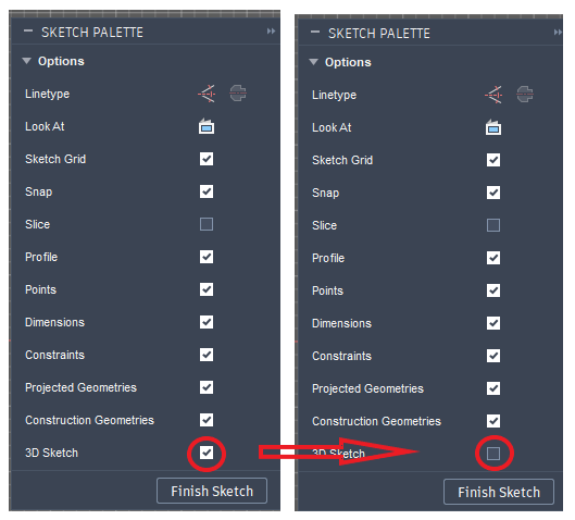

If you are getting a green checkmark and it is not giving you a warning that it discarded a contour, it is likely the contours are on a different plane.
When doing brackets, it is best to turn off the 3D sketch on the drawing palette. That way you won’t inadvertently put a point on another plane.
Another area that will trip you up is doing a bracket, extruding and then using a surface to do another sketch. It may look like it is on the same plane because in the straight on view, everything is aligned. But the sketches are on a thin slice away from each other.

I exported my old library over which wasn’t much to switch. I only have one plasma saved in there, and I just change the feed rates for different material’s as I go. I also double checked the 3d sketch option it was still turned off. Fusion was down an only able to work offline so ill try again later and see what happens. Thanks again for the help and ideas, hopefully we will get this figured out. Up until now I’d rather enjoyed using fusion over the last year
