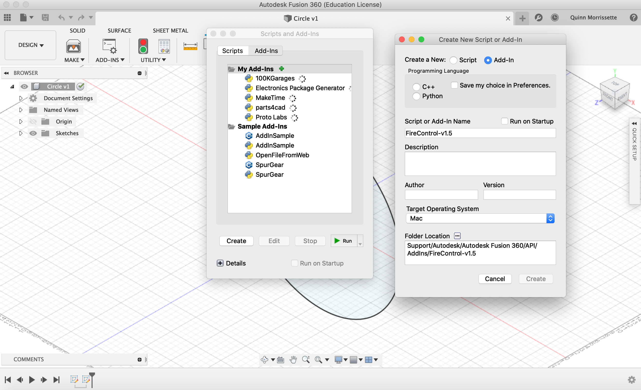

I’m having trouble connecting Firecontrol. I’ve tried creating a new add in and Fusion won’t allow me to create
Appreciate the help!
Hi QDM-
The Post file you are attempting to install isn’t a script or add-in and is installed differently. Please follow the directions in the manual below.
http://www.langmuirsystems.com/software/fusion#post-firecontrol
Hope that helps!
