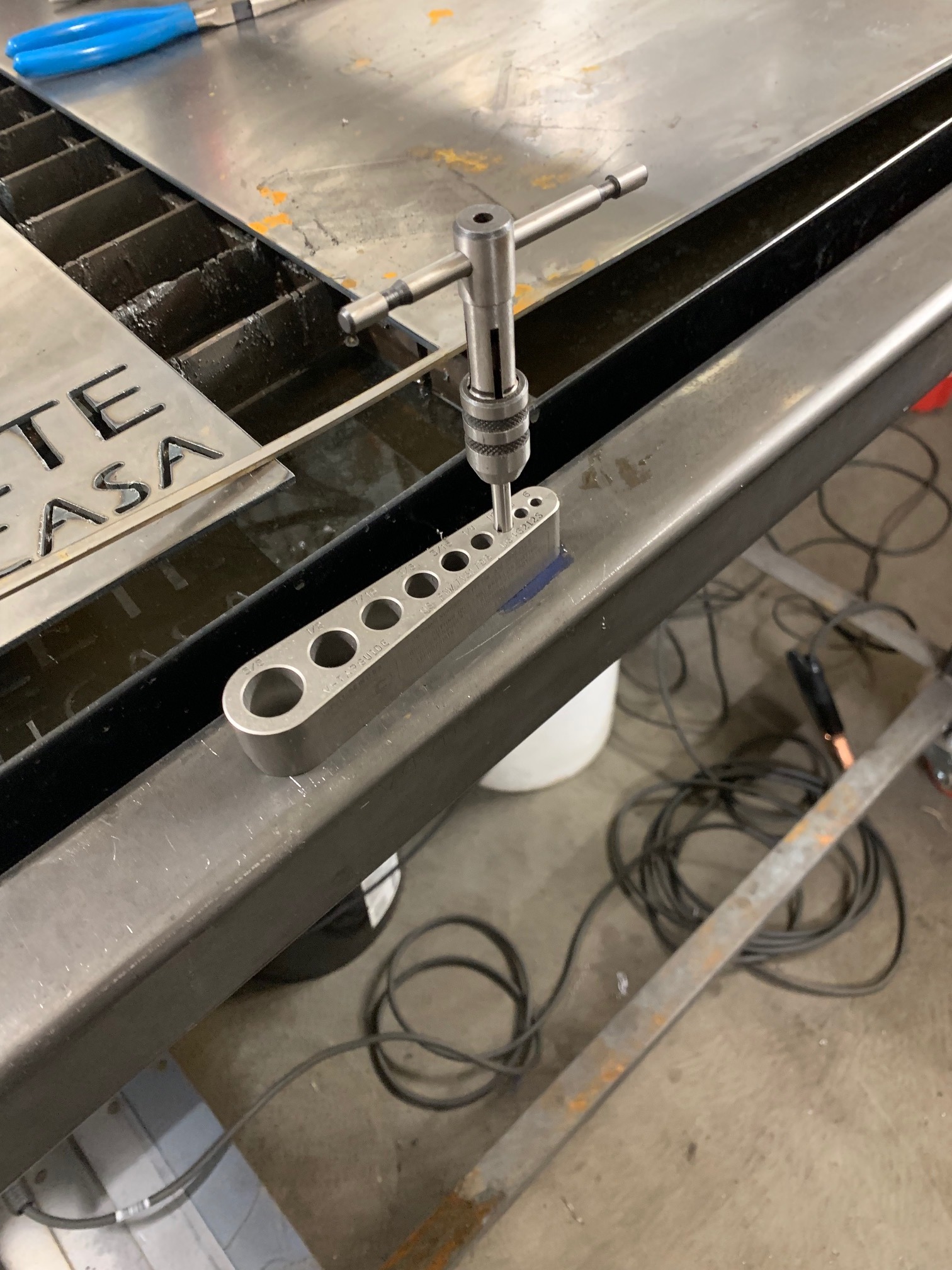

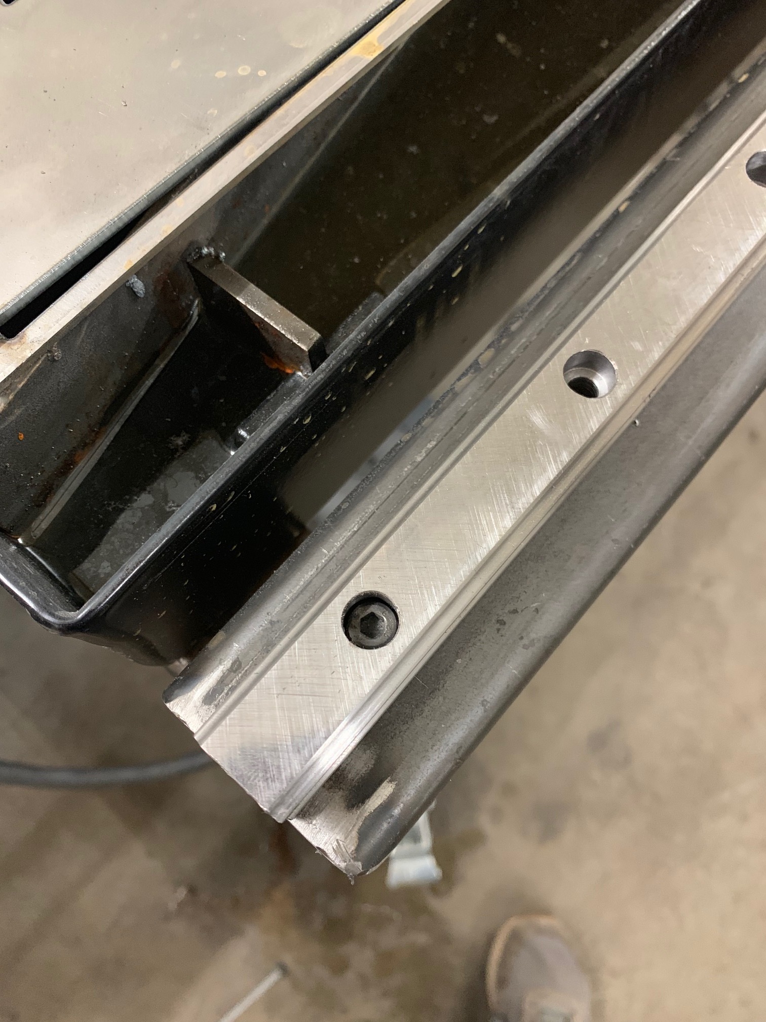

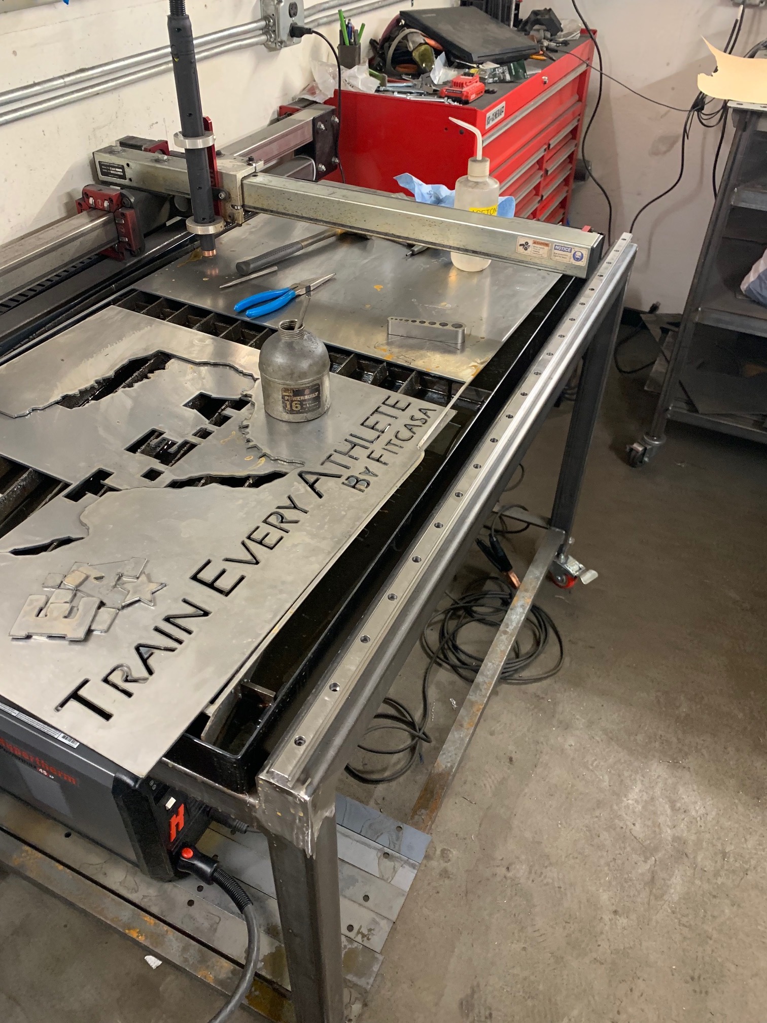

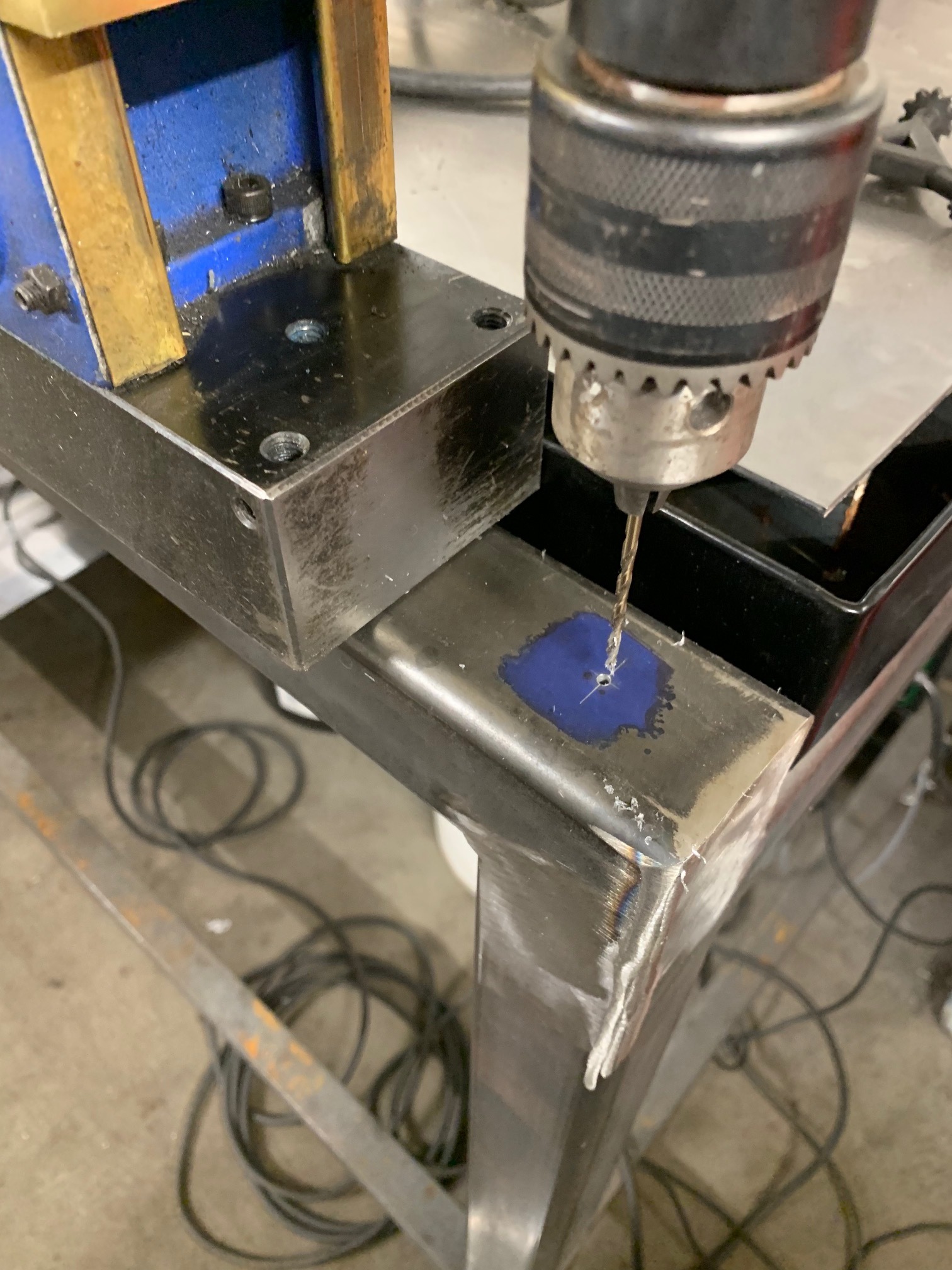

Started mounting the rail.
Just put 3 screws in for now, to make sure everything will work right. No sense doing all 10 to find out it doesn’t work.

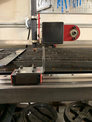

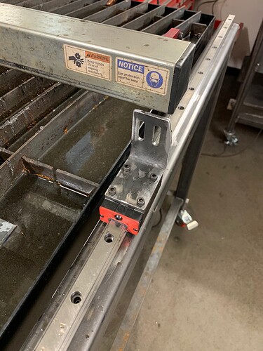

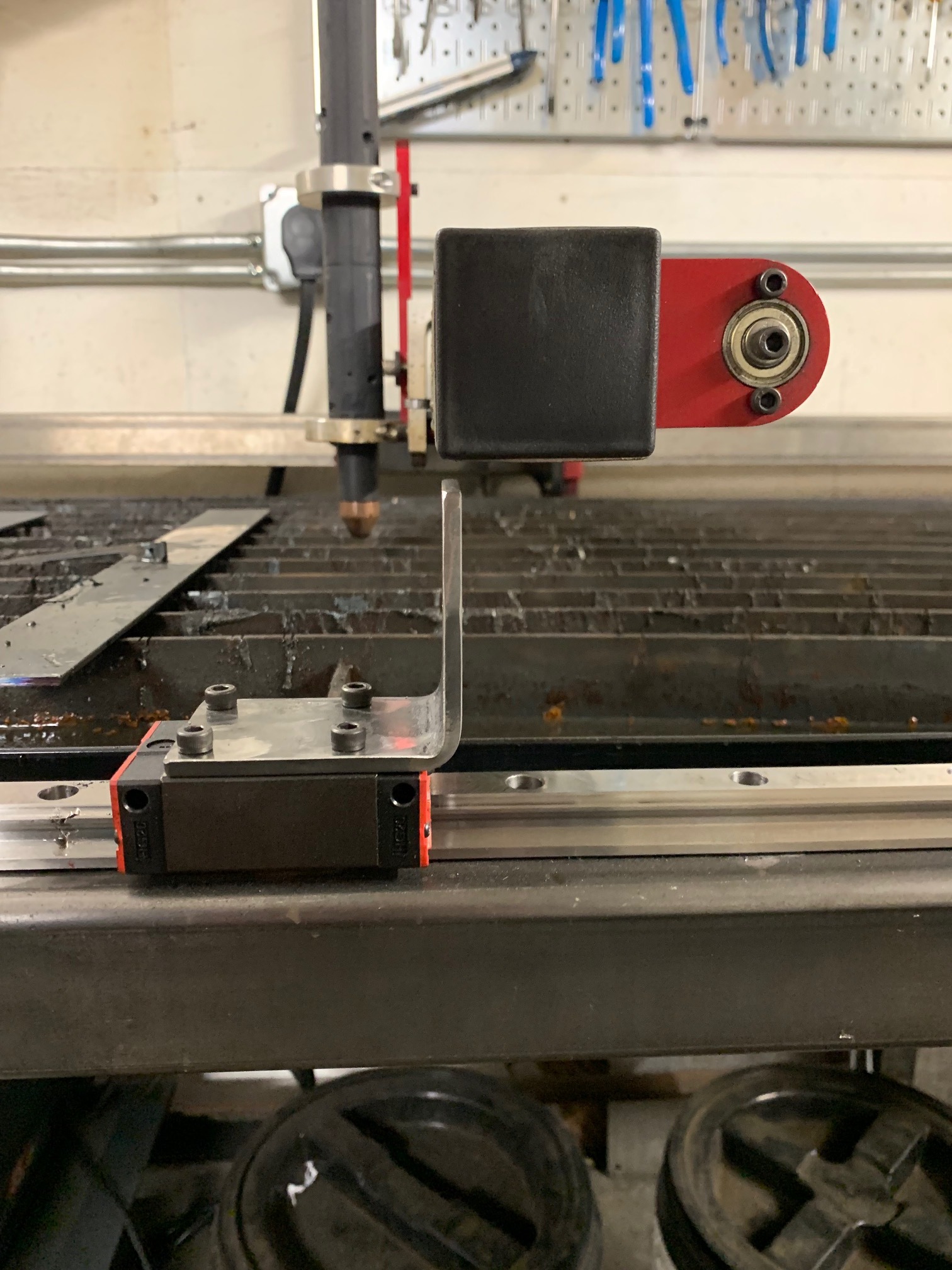

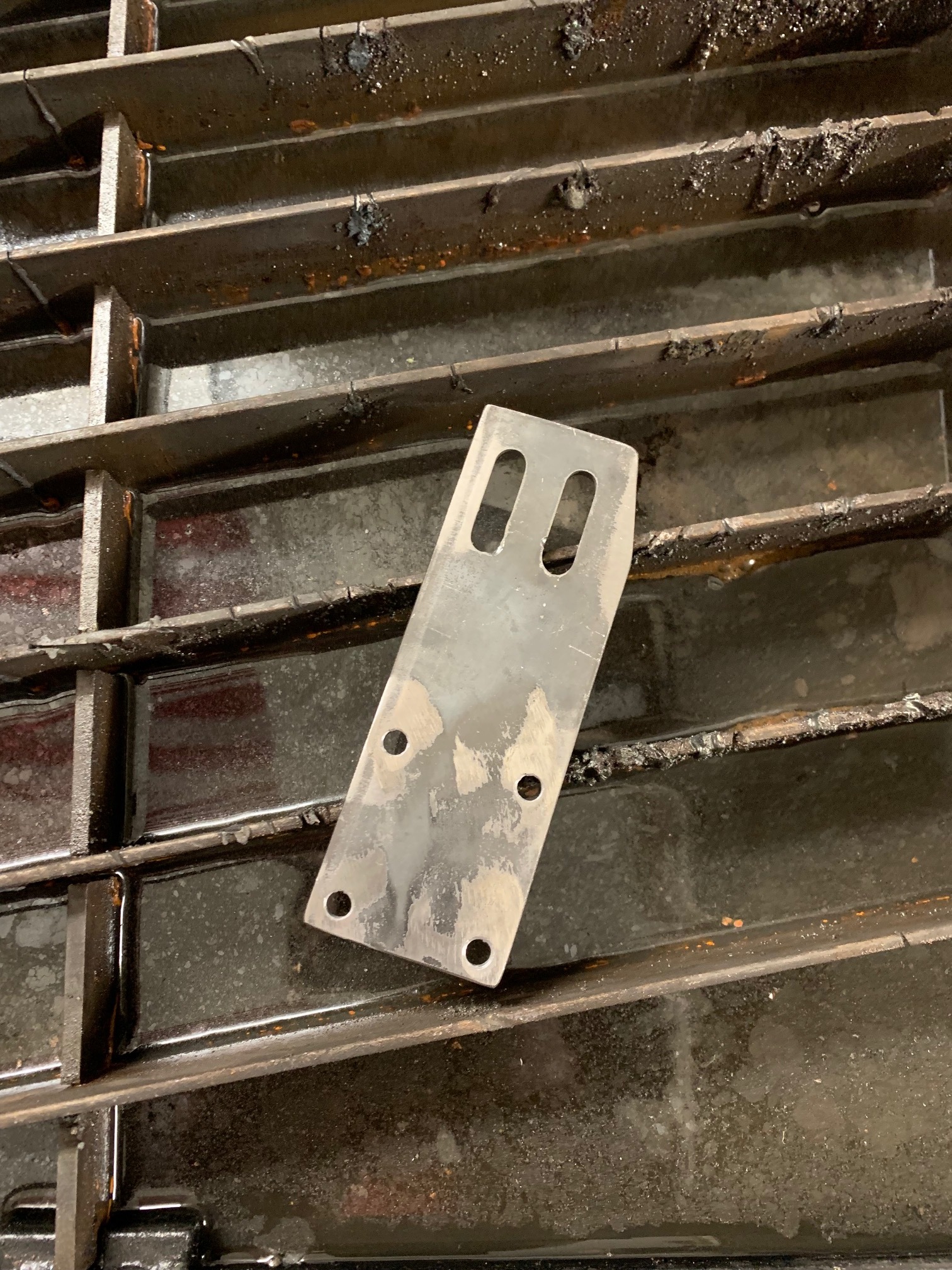

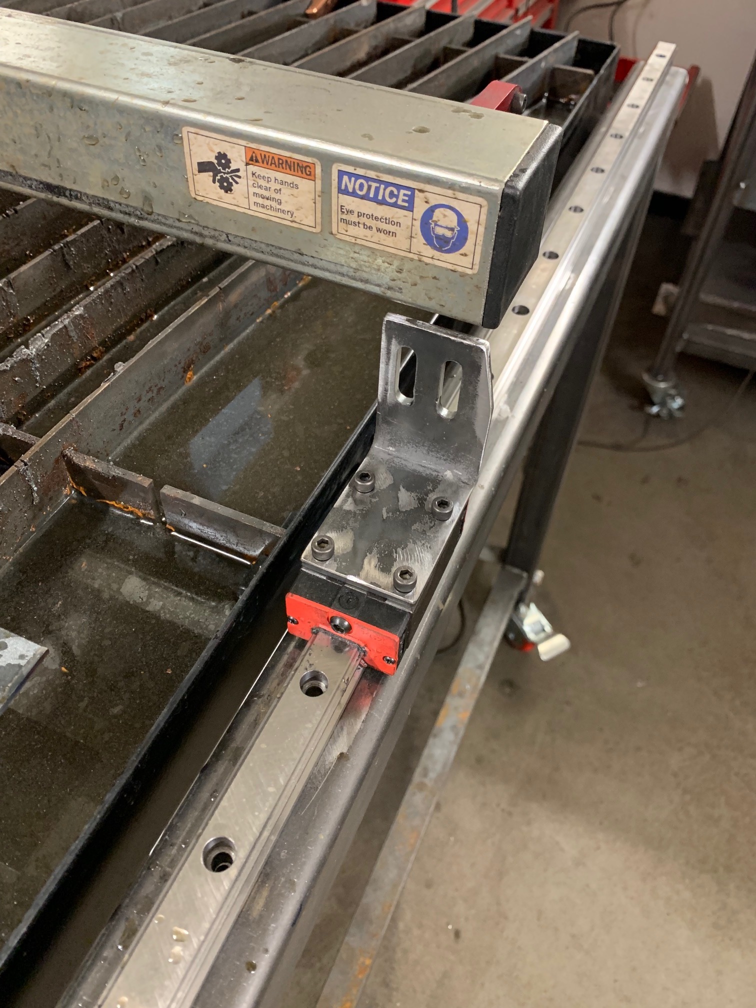

Started work on the brackets for the linear slide. I am remaking it because its taller than it needs to be.
The bracket will be a S shape. It has to be offset because this whole thing was an afterthought and if it wasn’t offset the slide would run off the track.
Looking great!
Just waiting for the 1500 mm rail to get back in stock on ebay.

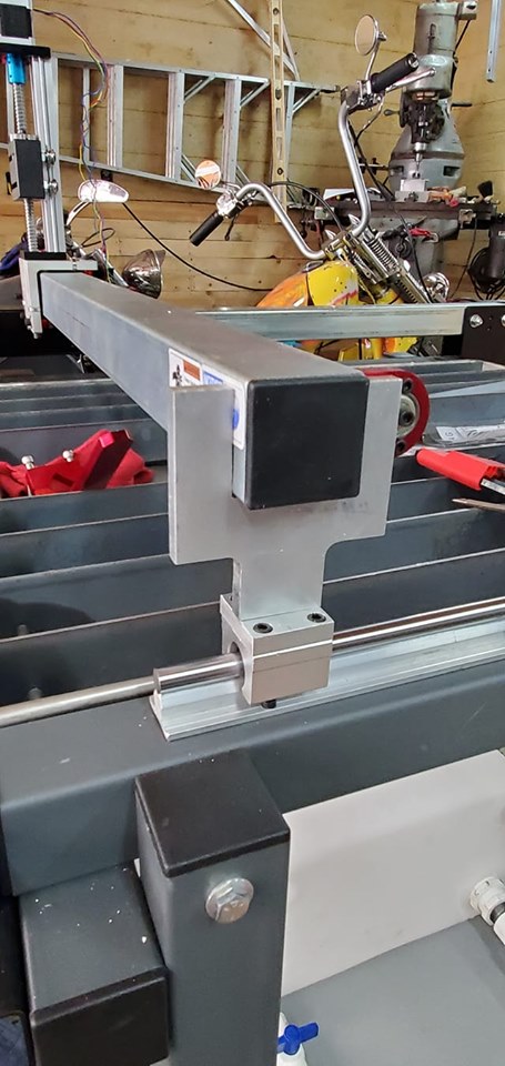

This is how I did mine simple, but works… just a shim change at the bottom of the rail to adjust. I left a 1mm gap at the bottom, so nominal is 1mm, adjust up or down from there with a shim change. No problem running the table at all, no drag. I still have to radius the outside corner, but thats just for looks… Also, I did run a dial indicator along the whole slide rail, it’s within .010" across the full travel.
