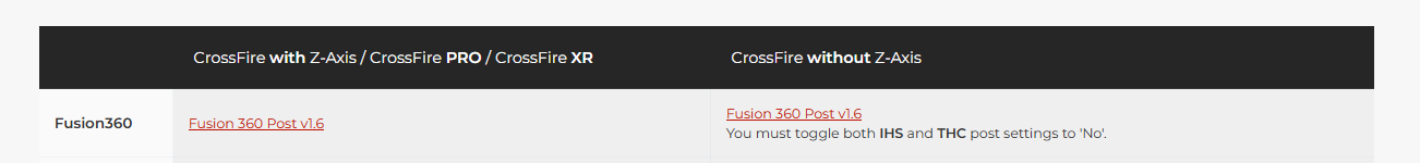

Make sure you have the correct post processor loaded on your computer and then tell Fusion 360 where that file is located. This link will show you where to find the post processor file on the Langmuir site and the graphic will show where you would enter that in Fusion 360.
