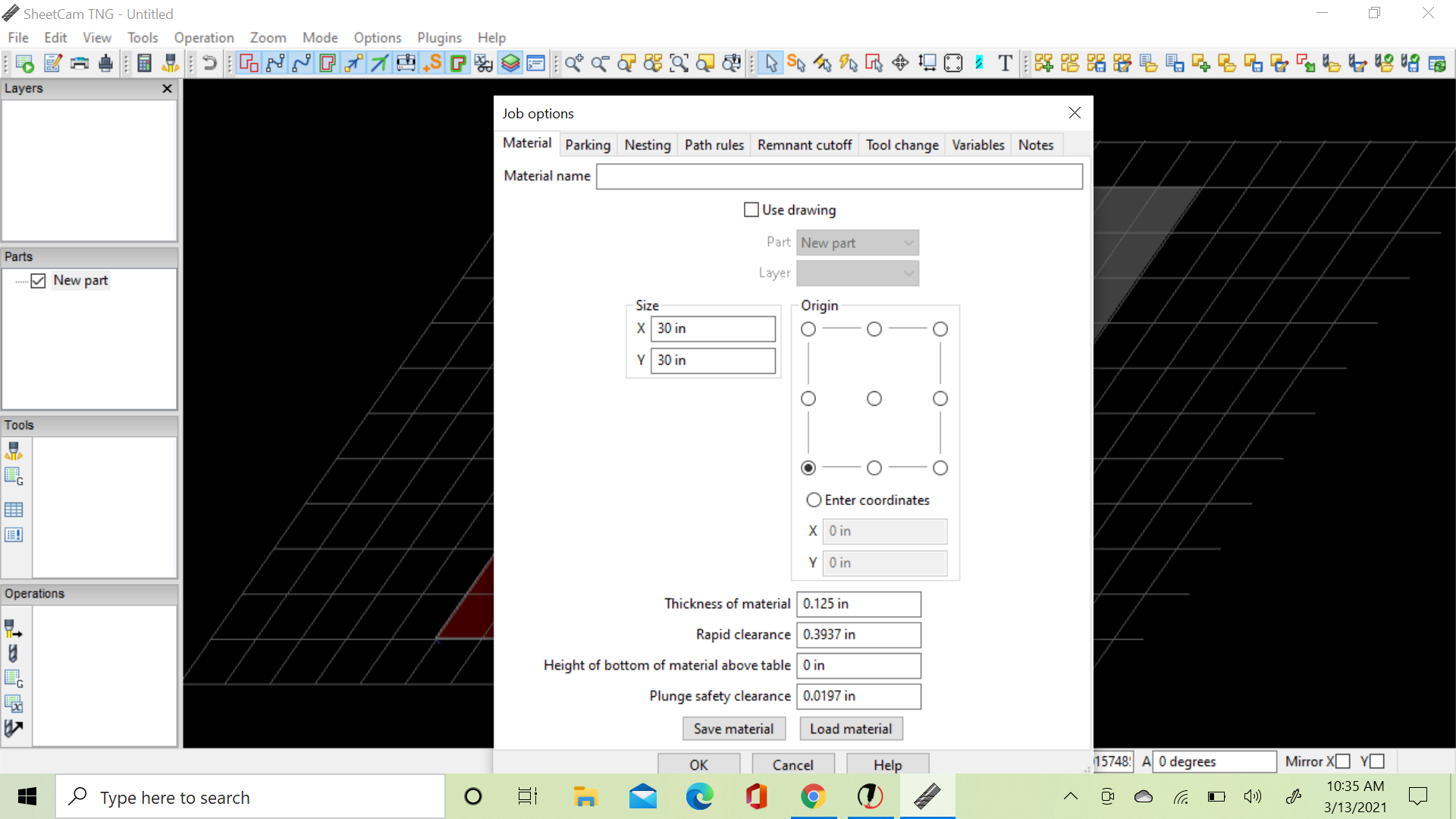

Error for line 17 Sheetcam - SOLVED - Needed rapid clearance and plunge safety set to 0
I don’t think i saw it mentioned but what table are you running ? the 2x2 or Pro?
im using sheet cam version 7.0.4., as for the post processor i used the edited version as downloaded but same result @langmuirsystems
im running the xl without height control.
@nicaDd @toolboy @TomWS @langmuirsystems would any of you have a program that you could share with me that works on your end to see what im doing wrong here?

when i load my tap file to fire control, FYI to everyone i figured out the problem and im up and running. thanks for the help!!

be nice if you said what the problem was so others can learn from it…
the mistake i made when i started was not looking at job options, my rapid clearance and my plunge safety clearance were not set to 0. once i made sure everything was at 0 my programs started working.
