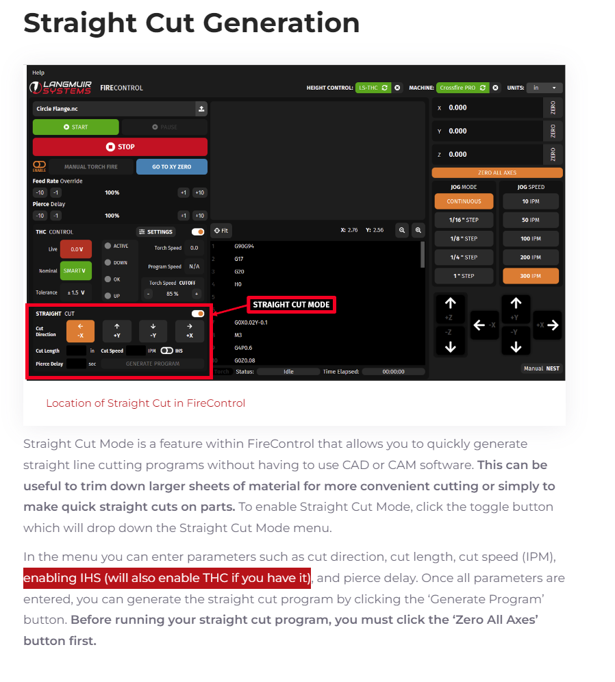

THC is not in play during the straight cuts. Neither is IHS as the torch has to fire away from the material and then leads in to transfer the pilot arc to the cutting arc as soon as the travel brings the torch over the material. If I used IHS I wouldn’t be able to cut the entire length/width of the material.
Also I believe THC is not supported by FireControl when the straight line cut operation is programmed in FireControl.
I manually set Torch height for the straight line cuts to both heights provided by using the gauges that came with the Crossfire. The ones that one would use if the THC option/add on isn’t installed.

I didnt realize you had no THC
"enabling IHS (will also enable THC if you have it) "

I have in the past butted a scrap piece of material up to the edge of the material being straight cut to allow the IHS and THC to operate, So it start on the scrap then moves on to material being cut.
I do have the THC feature installed but if I enable IHS the torch would have to move down and touch the material to determine IH and this would be my starting point to begin the cut. At this point the torch would fire directly over the material at a point where I wouldn’t be able to cut the entire length/width of the material and thus I would be left with a portion of uncut steel holding two pieces together. Unless there is a way of performing IHS and then moving the starting point off the material so the torch can fire away from the steel edge and lead into it and cut completely across.
I missed the last reply about the scrap piece of material so as to be able to use IHS and THC. That’s a good idea. That would make things so much easier. Thanks!
I’ve never tried this, but theoretically if you were to position your torch such that the nozzle is bisected by the edge of the material you should be able to use IHS and start the cut on the edge of the material. You would probably want to be mindful of the relative position of the starting edge to the nearest supporting slat, you would want that edge as close to a supporting slat as possible I would think.
