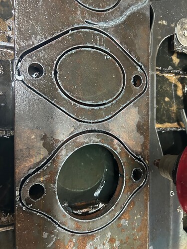

Cut Quality Issues and no change with setting changes
Make sure the air is not dropping below 60 psi when cutting,also check the torch height.
I ran an old program cutting 14ga and it did fine but it dont like this 3/8"
set air to 79 at rest and 70 run
tried slowing down to 35 ipm then to 30 ipm same silly stuff

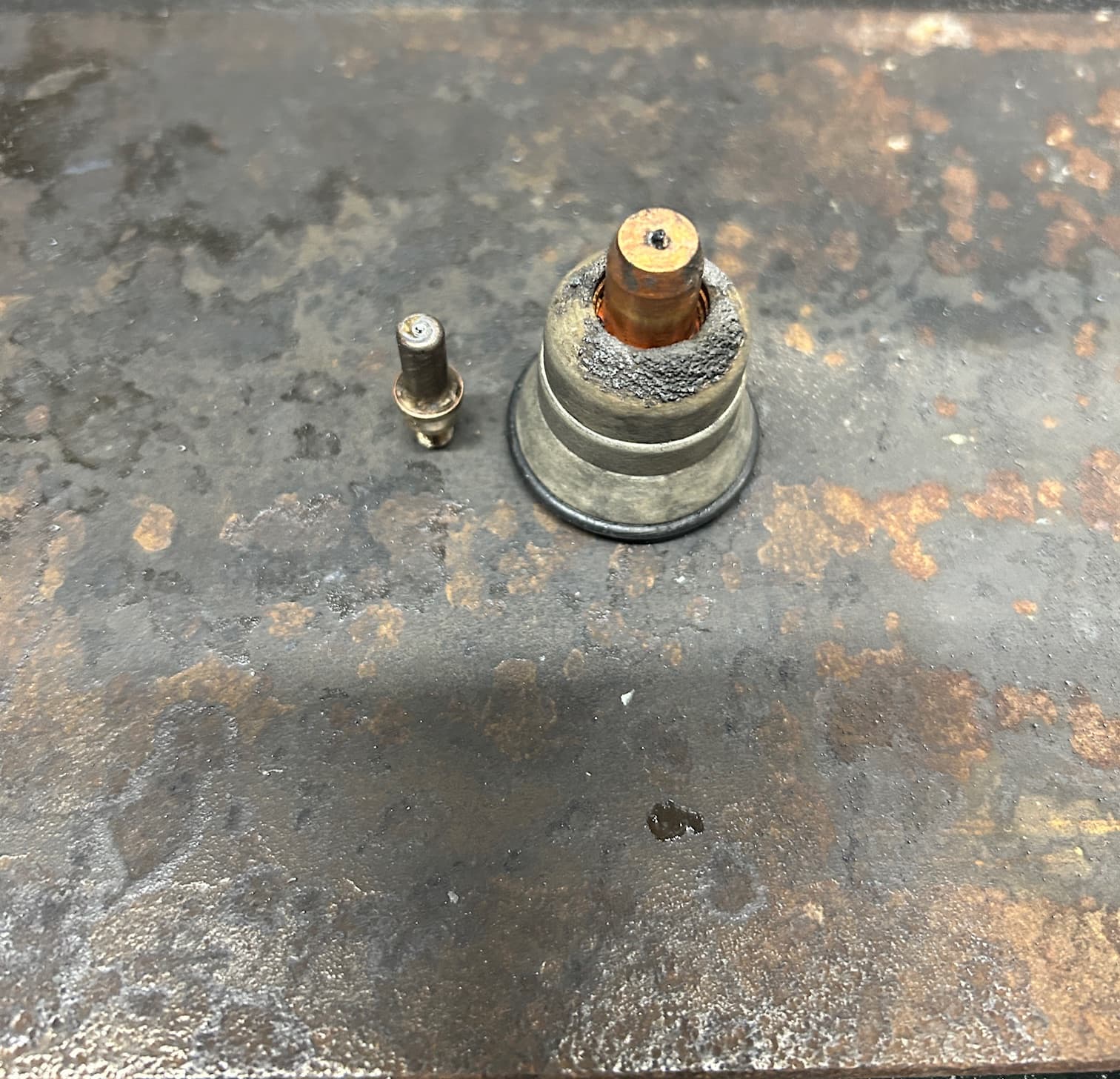

and its eating tips
So you cut an old program and it worked? Have you tried to re post process the flange design? I have had that happen for a time or two.
yeah i reposted it in fusion at the slower speeds but that didn’t seam to help
it seams like it just don’t have power but it cut the first flange fine then went kaput
I hope you don’t have a plasma cutter issue. Maybe a torch problem? I recently had George rebuild a PTM80 torch for me, which cuts much better than before he worked on it. Do you have another torch to try? I’m sorry this is happening to you.
That’s a good idea i can put the hand torch on there and try that

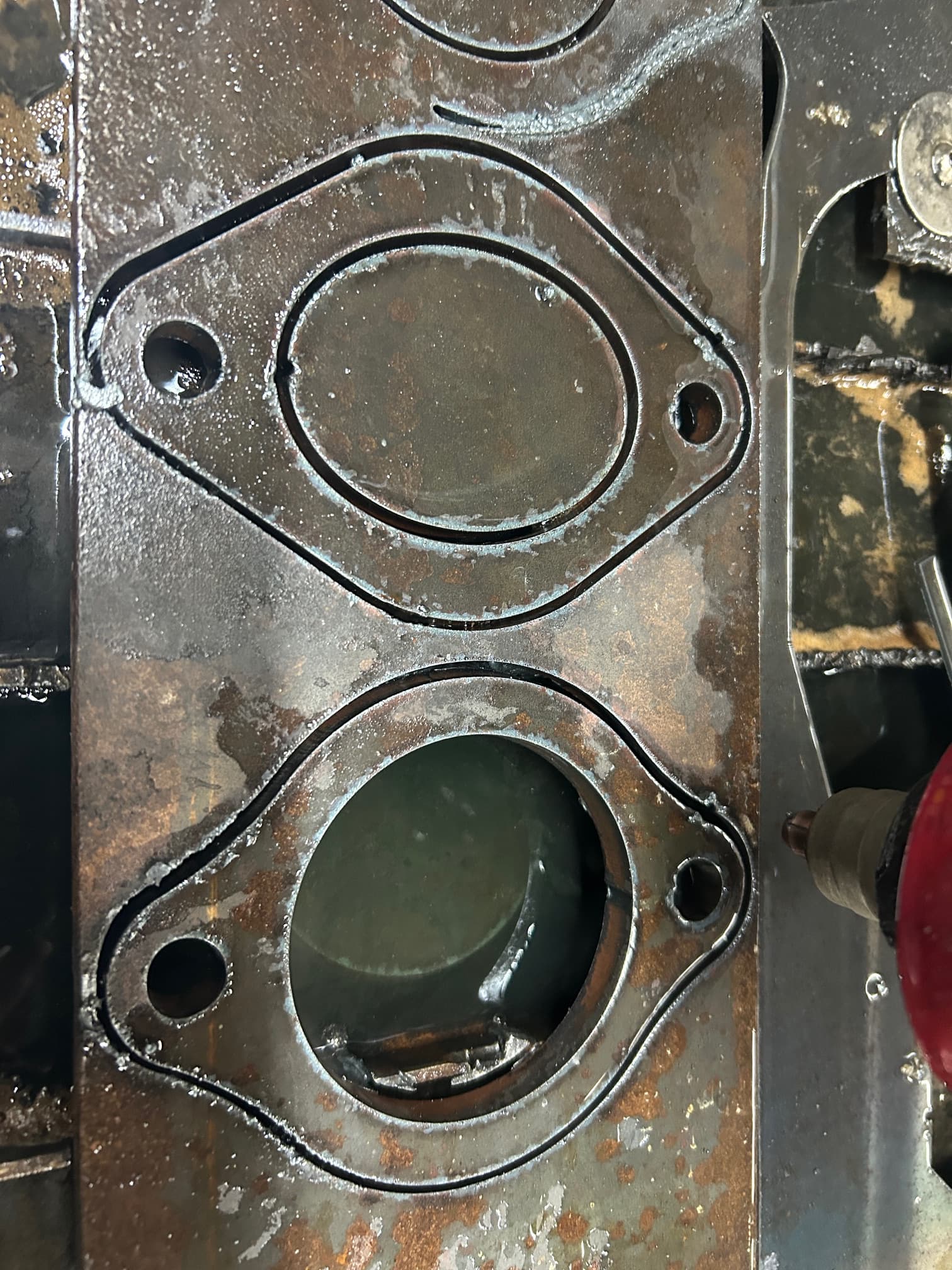

well i think i got it
I tried once more but at 20ipm and it worked !
Thanks again Guys !
