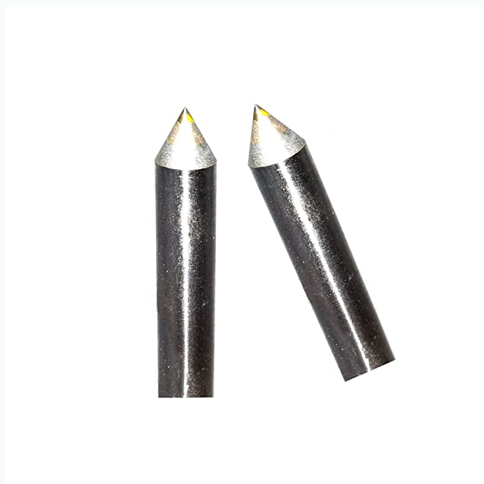

FYI, The EasyScribe and others like it are Diamond tipped, not carbide tipped like a scribing tool. I use a spring loaded tip that has a 1/4" shank.
https://www.amazon.com/gp/product/B07DK1TWKG
i think carbide would work for most of what i need if for. i mainly want to mark centers for holes i want to drill/ream on the mill. i have a transmission adapter i need to finish that will be in aluminum once i get done with steel mockups and the plasma just isnt accurate enough for alignment dowel pins.
https://www.amazon.com/Chendawei-Diamond-Engraving-Ceramics-Ingrave/dp/B097PRLJGF/ref=d_ci_mcx_mr_hp_d_hf_sccl_1_3/136-7362979-9305533?pd_rd_w=gJCR9&content-id=amzn1.sym.db557a2e-3be2-49be-abd4-60fa573c46fc&pf_rd_p=db557a2e-3be2-49be-abd4-60fa573c46fc&pf_rd_r=8RDXSSF9MX1TEBJHMAFT&pd_rd_wg=PS8QI&pd_rd_r=a15a5319-c458-4ebf-bc69-eecca5fe2e78&pd_rd_i=B097PRLJGF&psc=1
I am cheap too so I am trying this I have a lathe so I will make it fit
