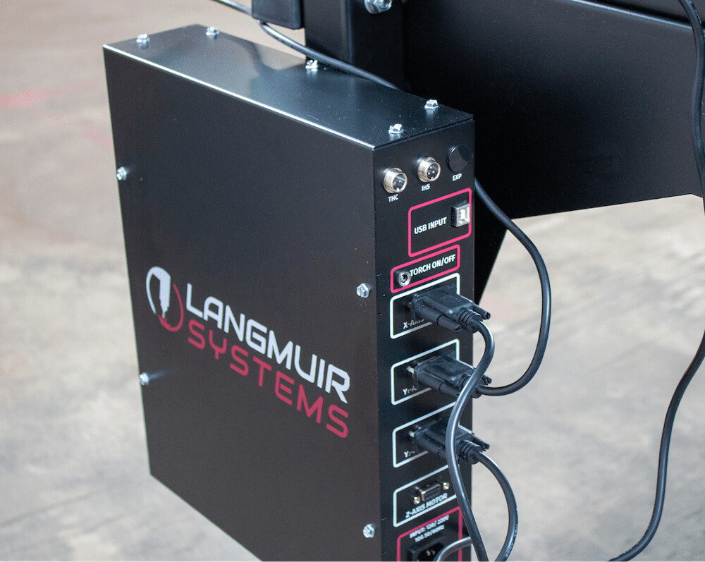

is the back of your langmuir control box where your cable plug look like this or is it all colorful?
if it looks like this then you should not be using Mach3…you should be using Firecontrol…free from the langmuir downloads page.
About 5 years ago and it runs the Mach 3software.
No it has the colors on the back and runs the Mach 3 software. I don’t know where else to go. IF this is a Mach 3 problem or a
