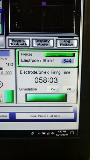

After a busy schedule with work, travel and the holidays I finally got to do some more cutting the other day and saw the pierce counter and cut timer working and got the following results.

So now I am starting to get an idea of how long the consumables are going to last on this material. So maybe in the near future I will be able to predict when a tip may fail in the middle of a project.
All of the cutting was on 18g material.
Is anyone else seeing similar results?

Picture #1 the tip and electrode don’t look that bad for an hour of cutting. A little moisture won’t heart ,yes its spinning the air counterclockwise but if its working then keep it that way.
Picture #2 they are bad and need to be changed out, but then it was also an hour of cutting time.
Yes, the second one I ran until failure, last cut on the tree of life that we are doing for gifts this year, changed it out and restarted the cut on the last cut and didn’t lose the project. Good learning on how to restart.
I remember when we talked you said to try it both ways and back then this worked best but I have changed some settings since then and will try it the other way since I have a little more time with it and a better understanding.
Thank you for your help.

My goal in doing the counter was to be able to predict when the consumables are near the end of their life. Sheetcam list how many pierces the project has and if I see that the counter in mach3 is only 25 away from the max pierces that I have gotten and the project has 60 pierces then I may choose to change the consumables before I cut that one or at least do it 1 cut at a time and evaluate the condition of the consumables.
