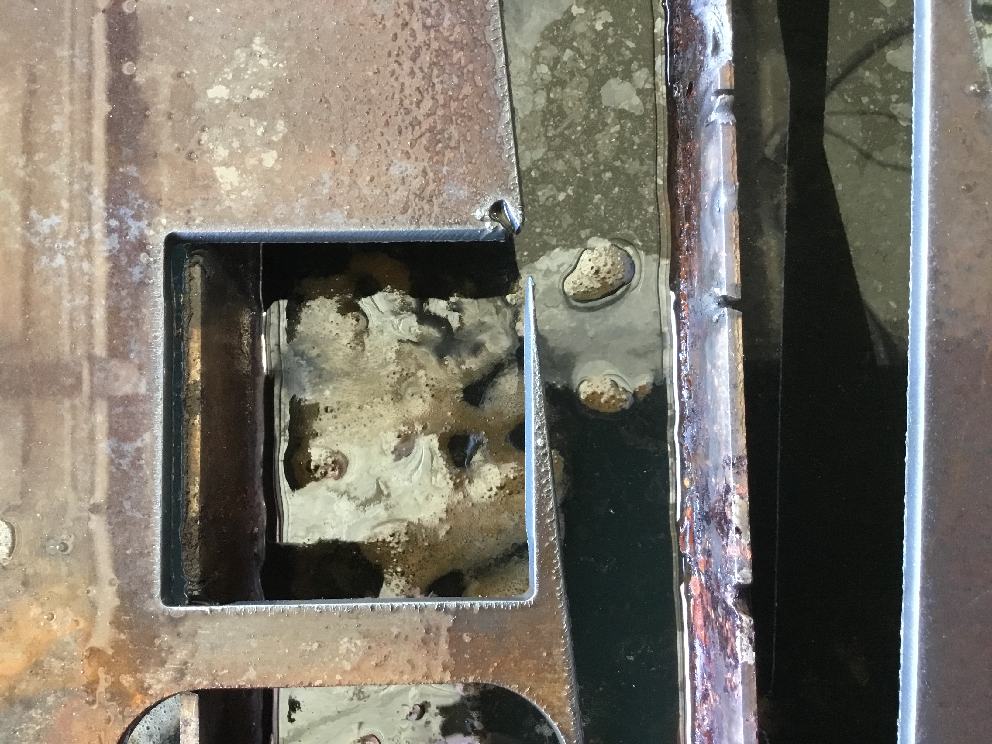

I notice my torch was not plumb after getting some bevels in my cuts. After spending the morning getting it pretty dang close I did a test cut and noticed I’m getting a bevel on X and y but on the opposite it looks great. Can’t really explain why.
Attached as much info as I think is necessary.

Main-Components-Of-A-Plasma-Torch-Cutting-Tip bevel on the top cut height is too high. Bevel on the bottom its to low.
Wide part of arc should be centered.

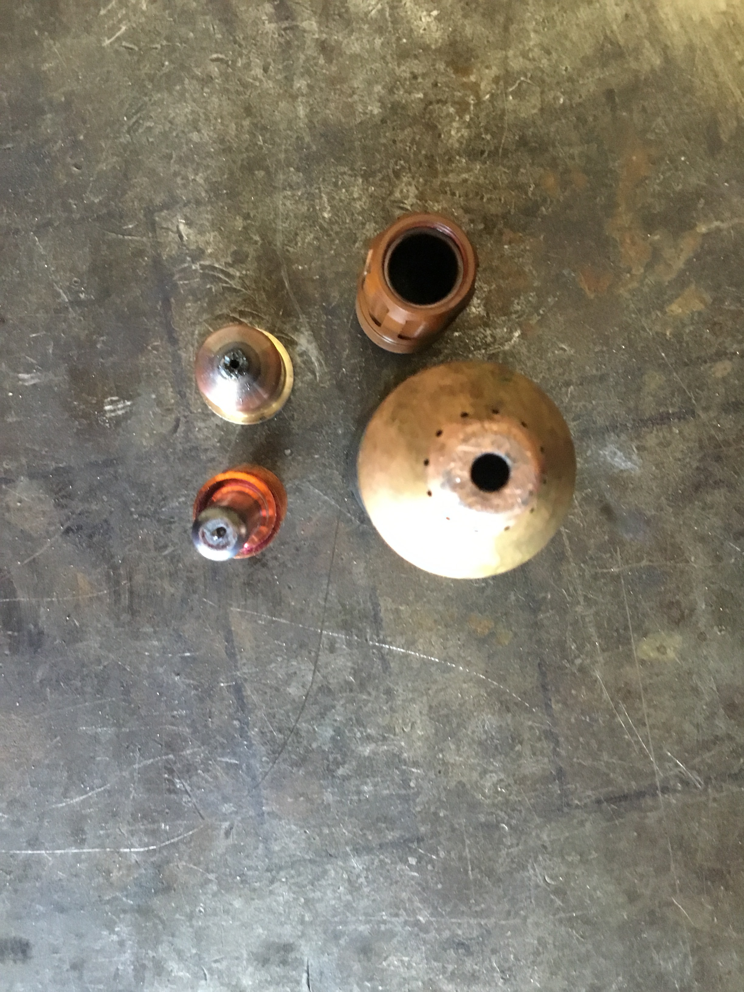

I did attach a picture of the consumables. Not sure if they are all that bad.(Still learning)
Your tip looks toast. Make sure you have a tip or nozzle that is not smaller than your amp setting. 40 amp nozzle at 50 amps will last about 1 minute.

I just did another cut and it looks like the Z is moving up which is causing the bevel. I set the height to .06 and it moved up on it’s own.
Replacing the tip and trying again.
Dumb question? Is the work clamp on the metal your cutting?
yes sir it is
After replacing the tip the bevel is significantly better but still exists, primarily because the torch lifts when cutting.

All the consumables in the picture are bad and need to be replaced. The tip is toast, the electrode is firing off center and bad, the swirl ring has been hot now that’s bad and you should also change the shield as its warn out also. It will never cut straight with those consumables.
