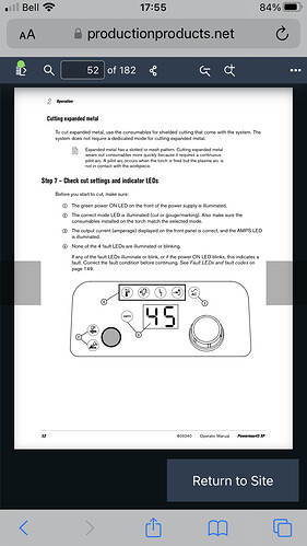

Anyone try to cut expanded metal?
I’ve got some drainage grates to make anyone cut expanded metal
I have. I turned off the THC. On my HP Powermax 45 there is a setting that keeps the ark going. I did straight cuts and it worked great. https://youtu.be/2q6sGnYxofE
I have the Powermax 45 but cannot find the setting you talk about in the manual. Could you tell me how to change that setting?
Hey. Is yours a powermax 45? Or 45xp
Mine is a 45, it’s older than the xp.
Looks like you don’t have to change the setting on the XP
