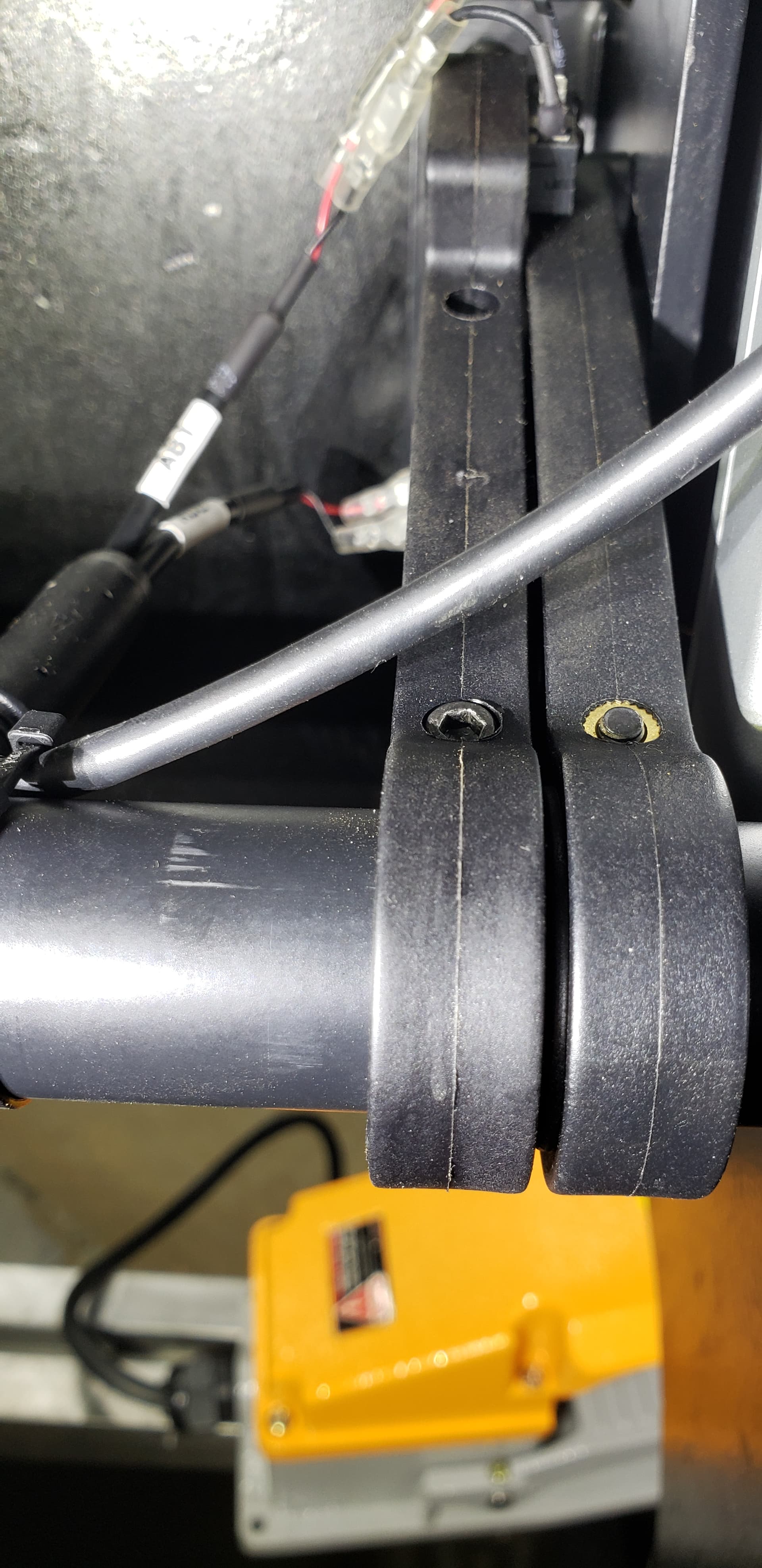

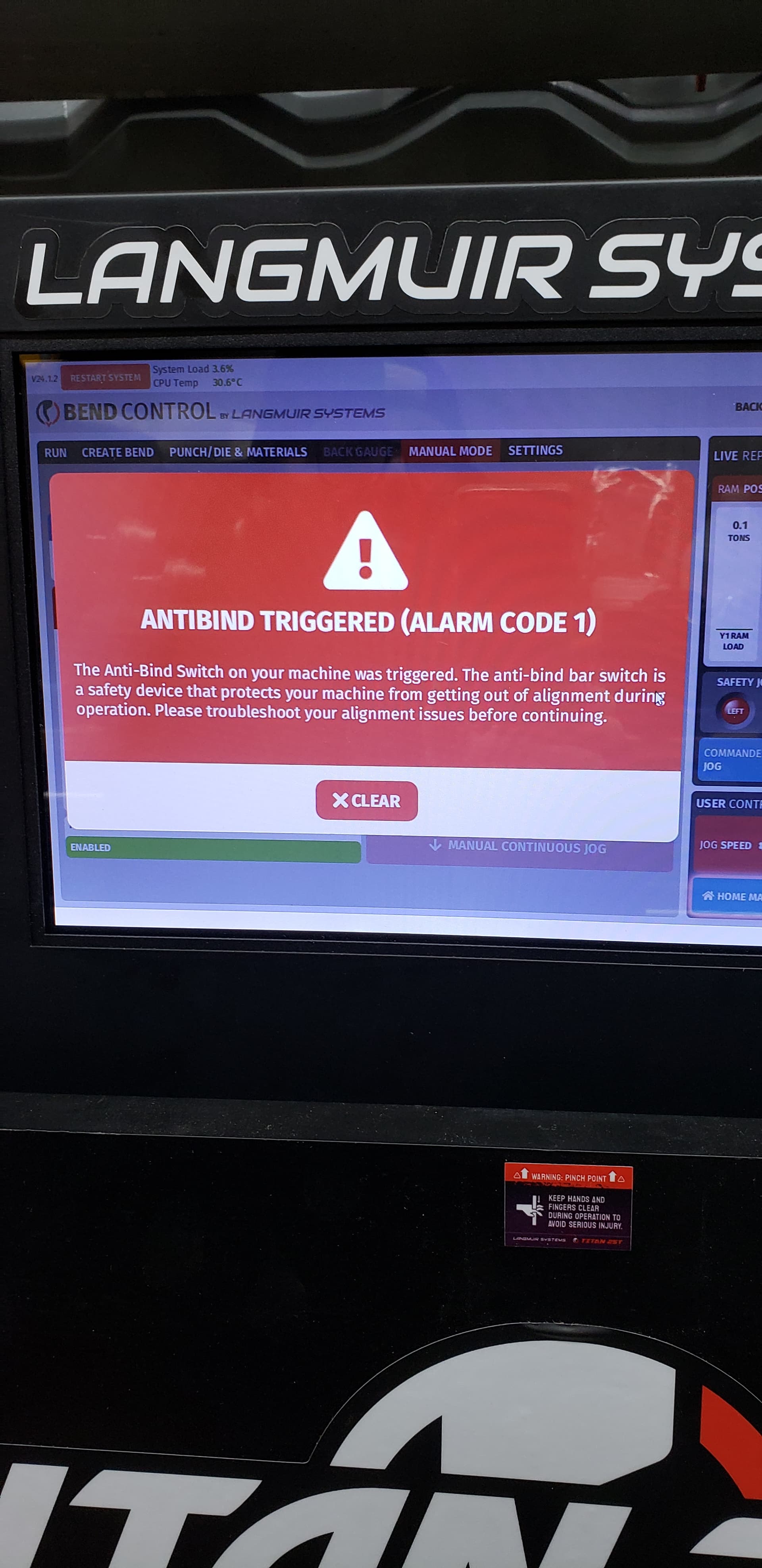

Just unboxed, trying to get up and running - hit home and error code 1 - ANTIBIND TRIGGERED. There are two plastic arms attached to the back cross bar, one of the arms has two mirco switches. The manual says the anti-bind light on the screen should be RED, and when it is triggered, it illuminates green- mine is green. seems backwards. I found no topics on the forum related to any issues with this trigger. any ideas? yes, i bled the air 2x already as the manual said to do if there are homing issues.
two missing screws in these two arms…one loose screw…robbed some out of the backgauge and installed them- no more antibind error1 .
