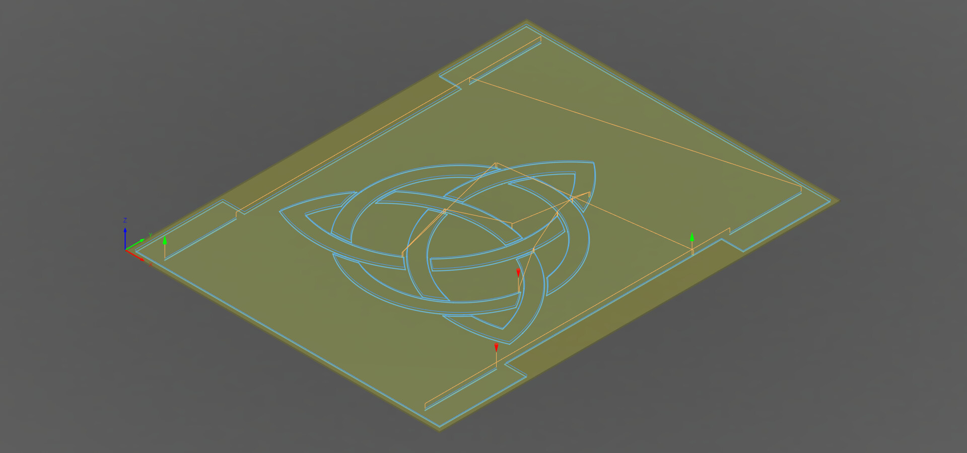

Another downloaded file - won't generate tool path
I’ve spent so long fixing this file, I feel like I should have just built it from scratch. I fixed enough problems that I was able to extrude a solid, but then generating the toolpath kept throwing weird triangles and failing/hanging. I fixed a few more problems but it still just sits there ‘generating tool path’ forever. Can someone take a look and tell my what the problem is???
Celtic Knot actual v6.f3d (238.2 KB)

celtic knot tin mob.f3d (369.3 KB)
I get it to generate but there is something with the shape that fusion does not like .
I think it is : Arcs intersecting acutely but it is just a feeling and I cant prove that .
I just want to see if I understand what you thought the fix was.
Adding the preferred lead in position?
That is what got it to generate a path.
I am unsure exactly what the problem was with this one.

clean knot v1.f3d (255.2 KB)
This clean file will generate CAM in under a second.

@TinWhisperer - watched the video. Great work. it only makes me realize how limited my concept of how to work in fusion is. I’m doing everything the hard way.
I’d like to scale the knot up so if feels the panel up a little more. But I can’t seem to select anything in the sketch with the circles - which is what I assume I need to scale.
Start a new sketch insert the DFX from above into it and then select and scale the knot using origin as the scale point.
I would run through it quick but I’m just on the way out of the office for a couple hours. @DonP or @ChelanJim may be able to walk you through it in the meantime.
Never mind, I as in the wrong sketch.
Sorry i just seen but figured I would do quick video if others want to see how to scale to a size.
Thanks for that. I could not get the DXF import editable. Every time I selected Edit Sketch, the import woudl disappear. I think I must have done the import wrong. But, I was able to copy the sketch and paste it into a new document - and that worked - so, thanks.
