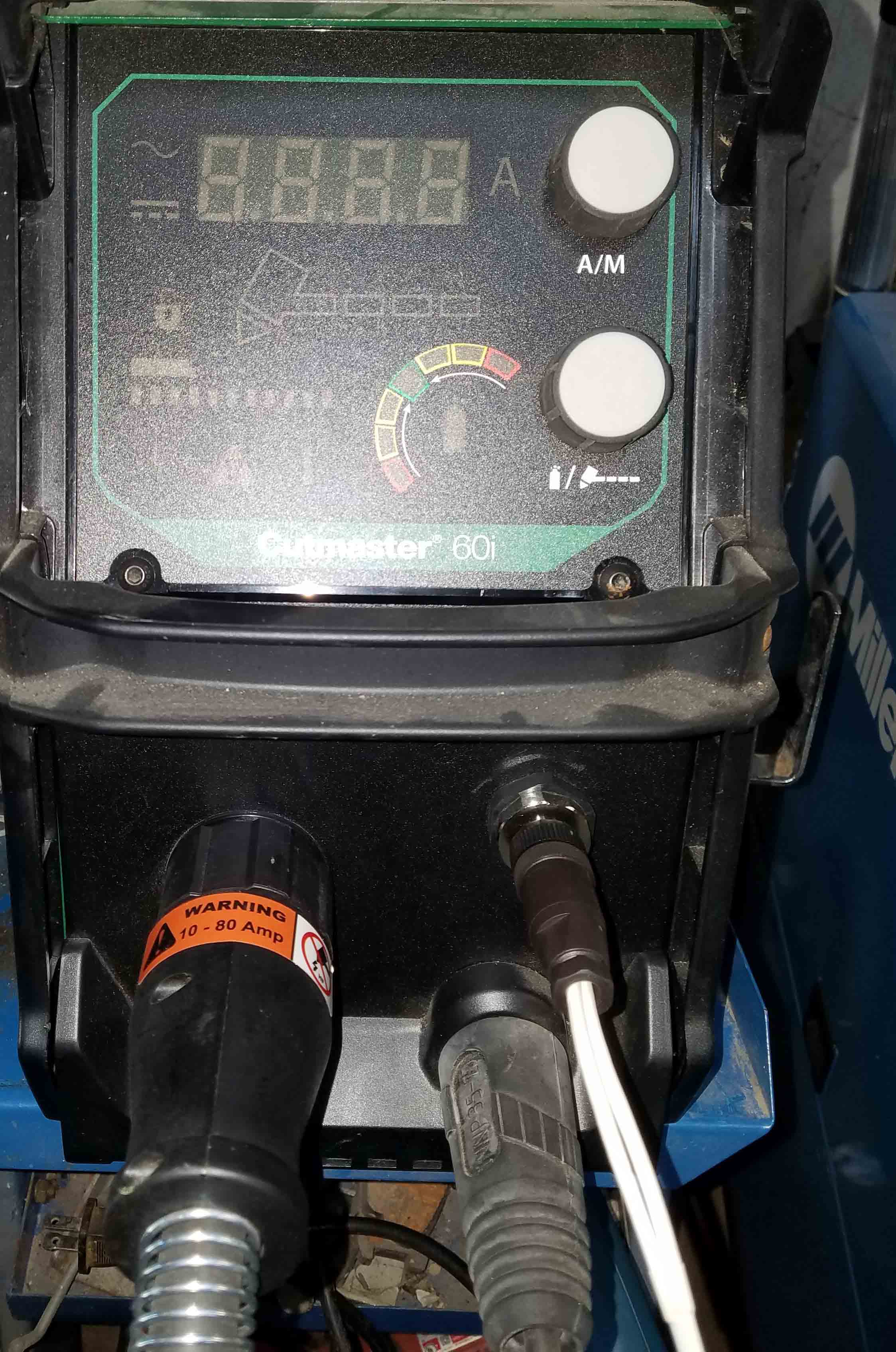

My first cuts with my 60i
Here are a couple of things I cut just to try it out. Thermal Dynamics 60i

I heard from Thermal Dynamics themselves that the 52, 62, 82 are all similar and use similar interface boards. They said that the i60 uses a different control module. I believe the 60i and the A60 have a similar pinout. If I read the manual correctly, the automation board is only for use with the A60, but they also have a pinout there for basic CNC Start/Stop and OK To Move signals. I certainly don’t mind trying to hack together my own interface, but I’d like to see what others have done first so I can learn what I can from them before I jump into it.
@Freetocut Thanks for snapping some pics when you can. I look forward to seeing what you went with.
I ended up soldering the wires in because I wasn’t getting a consistent connection with the provided taps. The wire coating on the 60i is pretty hard to penetrate. I found a connector in the trash bins at work, it had a few inches of wire on it and that is why I had to connect in that tight space. You can find a manual here for your machine:
https://www.esabna.com/us/en/support/documentation/downloads.cfm?directoryIn=Manual%20plasma%20cutting%20systems&path=/Plasma%20Equipment/Manual%20plasma%20cutting%20systems
It will show you the pinouts and follow the directions from Langmuir to double check.

So I wired mine up and it was pins three and four on the plug on the back of the A60 that need to be hooked to the control wire from the table.
did you use the basic cnc card or just tapped into the pins 3 and 4?
I used a plug that plugged into the cnc card.
Everything works great with it? Just curious. Lead time on the card and wire is 2 weeks from my local weld and supply store.
Yes, works perfectly. Would have been nice to find a plug that would have worked and not spent the money on the control cable. The 60A comes fitted with the card. You may be able to do a little searching and find the plug. I was in a hurry…
i used the plug and play card from thermal dynamics and bought the matching cable from ebay. has been working great for me for almost 9 months
