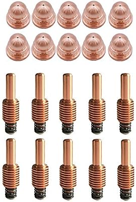

Heath, Can you provide a link to the Hypertherm 45xp consumables you get on Amazon? I found these but it doesn’t appear to have the shield. Guess that has to be ordered seperately?
Also, can you tell me how often each of the consumables needs to be replaced so I can order an appropriate amount?
I stopped reading at OEM and missed the “products not original” . ugh. I found that on Amazon, I was hoping Heath could point me to the ones he’s ordered. I did see the ones from Jack and somebody and know through the forum to not buy those. I had found a kit at HarrisWeldingSupply but didn’t want to buy the whole kit. Just the most used consumables.
