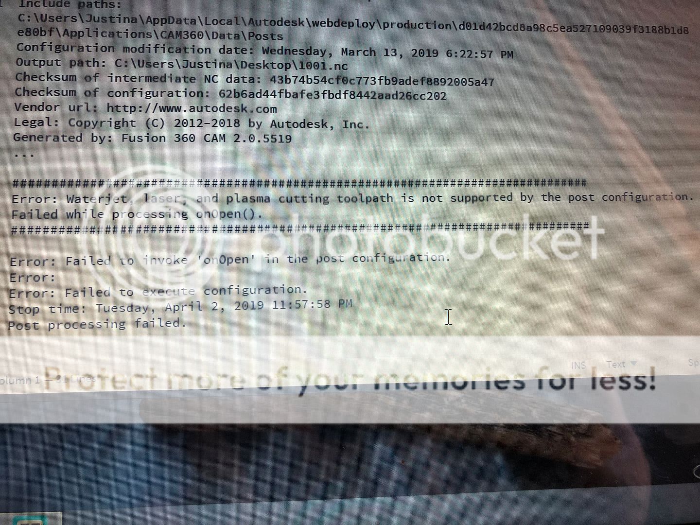

I’m am but a lowly welder and trying to have some fun here. I am running into problem after problem. I am not much of a computer guy at all but figured I could figure it out using the tutorial videos available. I’v tried bringing a couple different dxf files into fusion and when I get to the post process and save them it says they fail and I’m getting this. Im feeling a bit overwhelmed already as it is.
On the fail does it give a reason or a error code?
Where are you located?
Yes sorry I was trying to post a photo, that’s not working either of course. It says plasma cutting tool path is not supported by the post configuration. Failed while processing onOpen.
Failed to invoke “OnOpen” in post configuration
Failed to execute post configuration.
Post configuration failed

I think I may have gotten it figured out!
Please tell all if you figured it out for the next guy with that issue.
I was able to get it figured out. Was a single simple adjustment to the selection where you see Mach3 plasma/ Mach3 plasma (1)
I don’t recall what it was set to before but once I change that it worked perfectly. Thank you

I posted a photo above of how I fixed it
