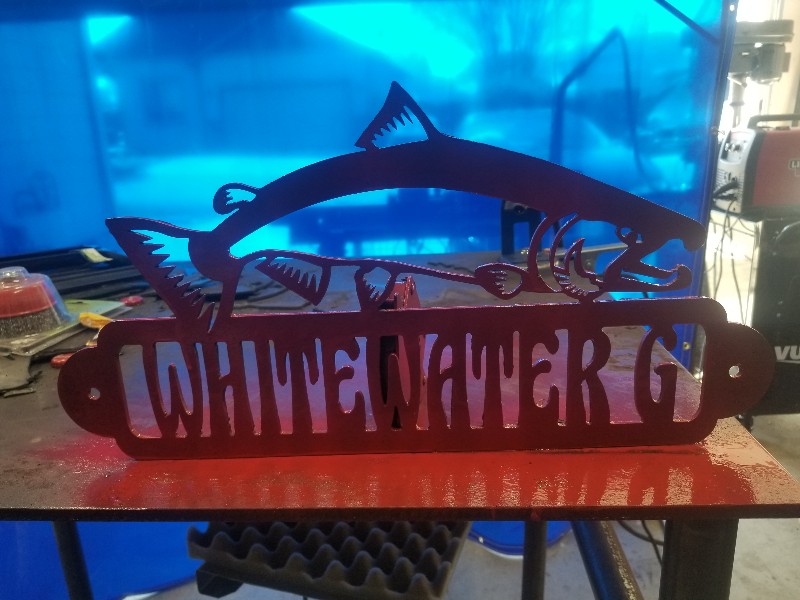

I appreciate all the responses, I think I have it figured out, I made a really intricate salmon sign for a buddy, i tried uploading it here but need to make it a smaller file. It turned out great. It’s cool to have people to turn to.
